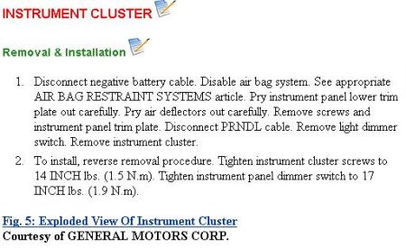

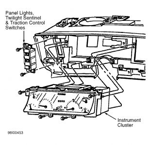

I need to replace some of the dash lightbulbs. Dealer has already told me it takes 11 number 23 bulbs (ie: not an LED strip).
How do I remove the dash and instrument cluster? (can't see any screw heads)
