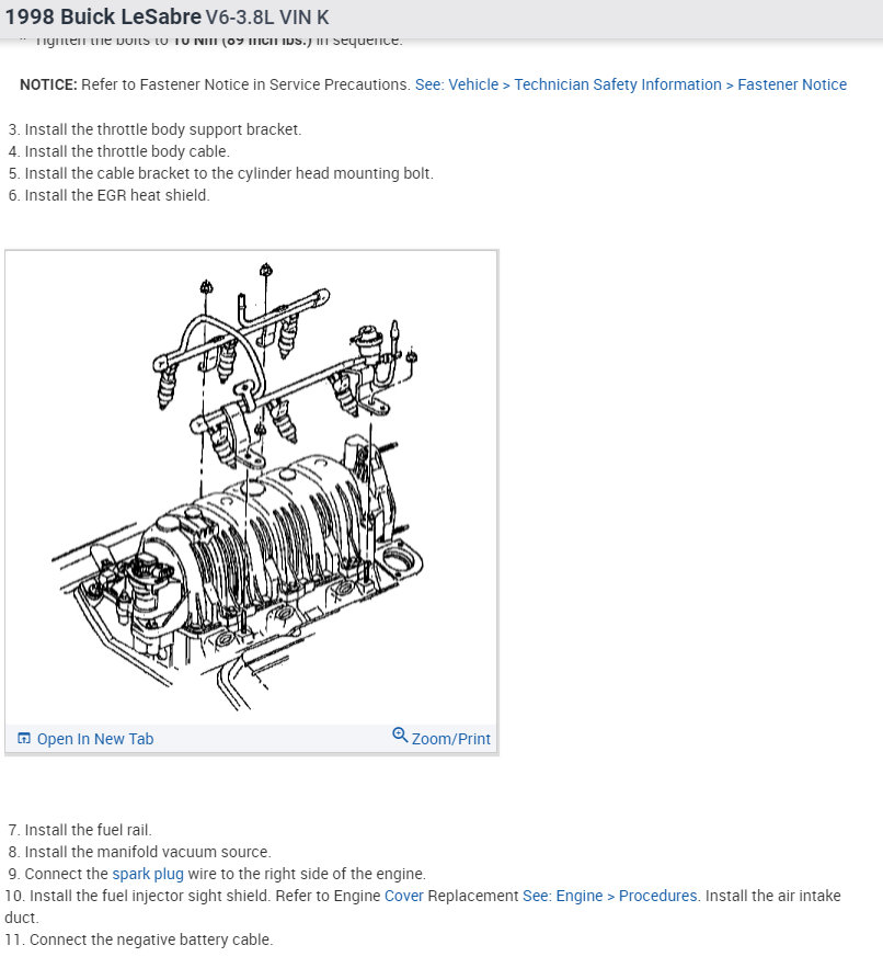

SQM, does a precautionary plenum replacement with the Dorman plenum seem worthwhile? Since plenums do not announce they are leaking, such problems have seemed to come out of nowhere to many Buick (and GM) owners.
Pro-active plenum replacement now, rather than later spending $800.00 to $1,000.00 to repair the engine, becomes much more attractive.
There are two plenums-- upper and lower. Because both are likely of the same plastic, are leaks possible with either plenum? If a plenum if purchased from Dorman, do you recommend both upper and lower?
Fortunately, I have had this car almost two years without major problems but have driven it little. I also am aware 245,000 miles enters a danger zone for parts failure. Already, I have replaced the battery, and worked through a VATS system lockdown (with the help of 2CarPros, Joe). Now, as the parts aftermarket for the Buick 1998 begins to fade, I am eager to pre-empt any avoidable problem. What is your recommendation? (I do not know the car's history, since the wife of the guy who sold it threw out his repair papers while cleaning house).

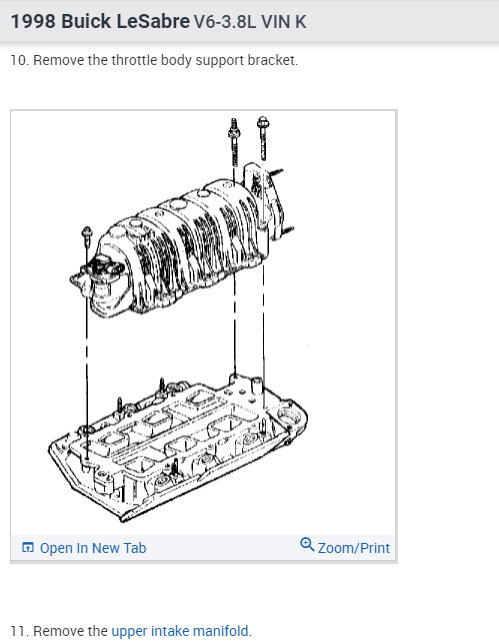

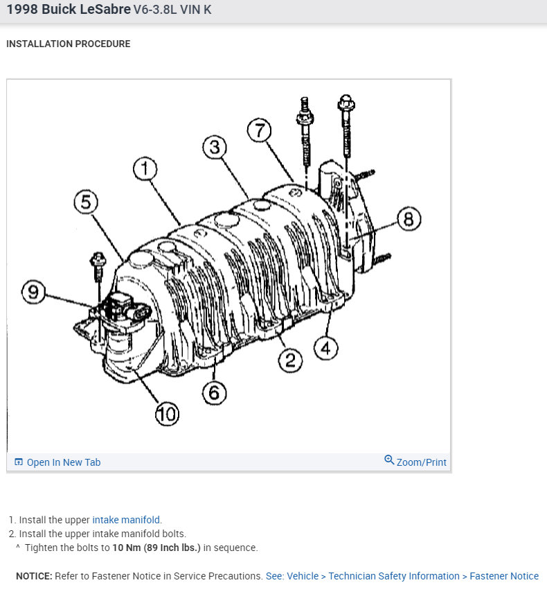

If I remember correctly the lower part is metal. Only issue I have seen is leaking gasket for the lower manifold. So, unless you really want to, lower one does not need to be replaced. Maybe just do the gasket to prevent it from leaking in the future.
The water pump is a common issue with these, so it will be a good preventative replacement. As for alternator you should only replace if it is bad, doing it beforehand may not have any extra benefit. Just about all electrical components falls under this.
Usually, those pulleys will start to sequel before going out.
One other common item is valve cover gasket leaking.
That is probably all the major items.
245,000 is surely high mileage, but I have seen these 3800s go well past 300,000 with basic maintenance and gasket replacements.
