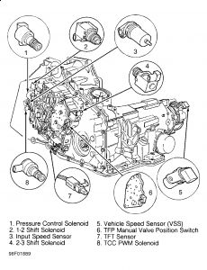

I had ecm scanned it showed tcc stuck on
tcc commanded off by ecm tcc slip detected after off command
problem cause tcc soleniod failure
open or short circuit condition
blocked passage in transmissioncheck transmission range switch for proper operation
unable to give any pressures with their scanner
I am going to change the filter and fluid will let you know how it looks in pan

There are a 1-2 shift , 3-4 shift, control solenoid and the TCC see diagram
https://images.2carpros.com/forum/automotive_pictures/198357_Graphic_284.jpg

can you tell me what transmission this has in it to assure proper ttc solenoid thanks Robert
Dec 29, 2009 at 5:28 AM
DOCFIXIT
  • 18,828 POSTS
4T65-E
