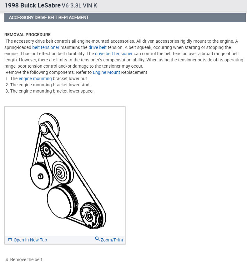

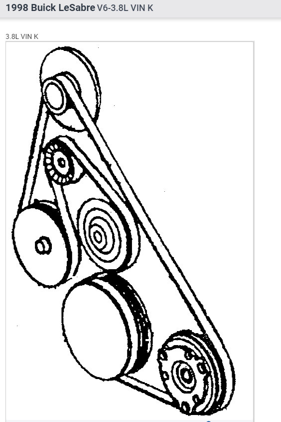

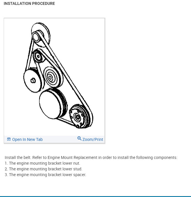

1998 Buick Lesabre Engine Size unknown, Automatic 67,000 miles.
How would I replace my serpentine belt on my car listed above?
Jan 27, 2008 at 8:44 AM
BMRFIXIT
  • 19,053 POSTS
pull the tensioner away from the belt remove the belt

Are you trying to replace the belt?
If so, to take the belt off you need to put a 15mm socket on a ratchet (or barker bar). Put the socket on the bolt of the tensioner pulley and pull it counterclockwise (you are not prying against anything).
