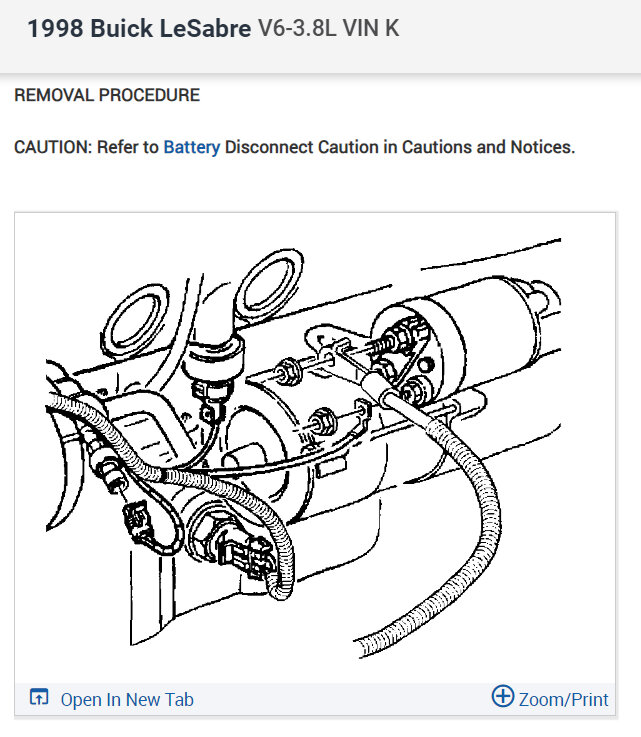

We replaced a blown engine and also replaced starter. Car started but now will not turn over. Makes a RRR sound when trying to start.

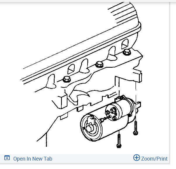

Yes, that is ture but to me it sounds like the starter motor is defective and needs to be replaced, here are the instructions on how to do the job correctly. Check out the images (below). Please let us know what happens.
