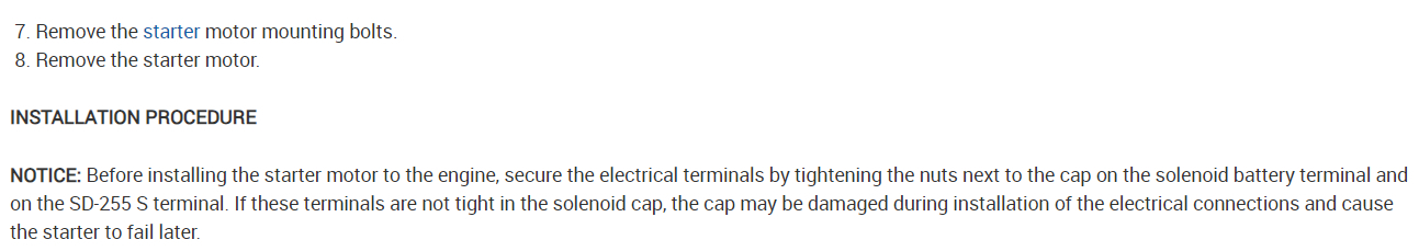

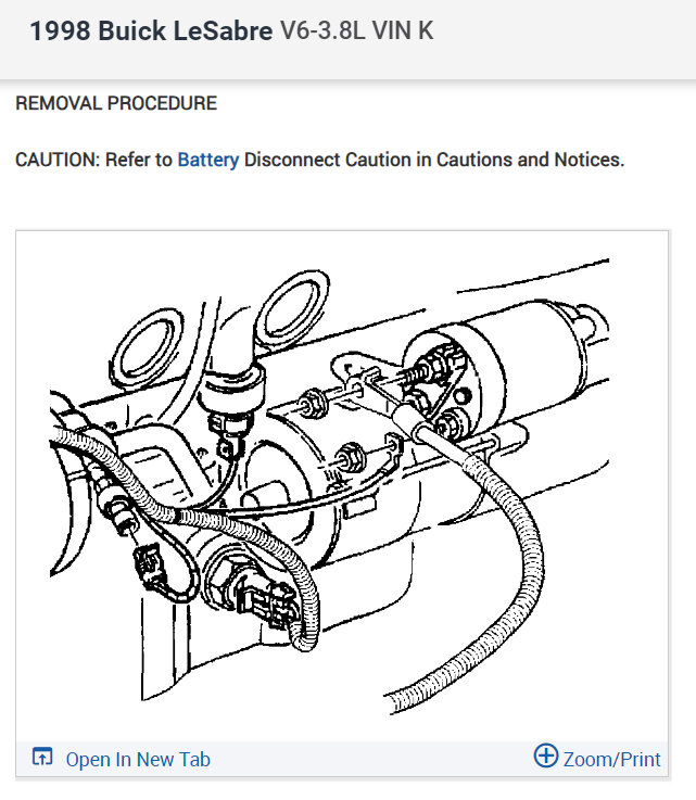

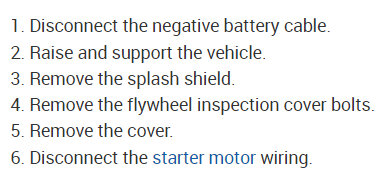

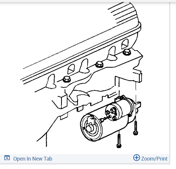

We replaced a blown engine and also replaced starter. Car started but now will not turn over. Makes a RRR sound when trying to start.
Dec 8, 2007 at 5:58 AM
MERLIN2021
  • 17,250 POSTS
You may need to put in some shims, or remove them from the starter...
Dec 8, 2007 at 6:39 AM
  • 55,433 POSTS
Yes, that is ture but to me it sounds like the starter motor is defective and needs to be replaced, here are the instructions on how to do the job correctly. Check out the images (below). Please let us know what happens.
