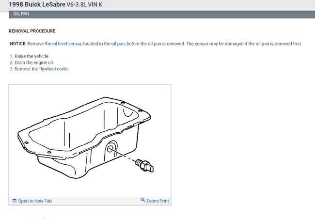

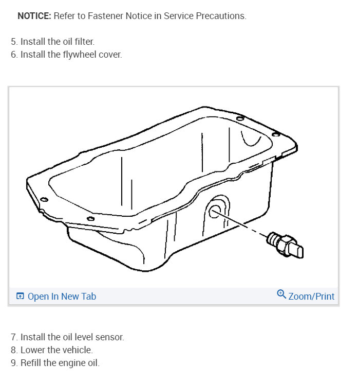

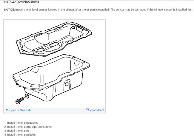

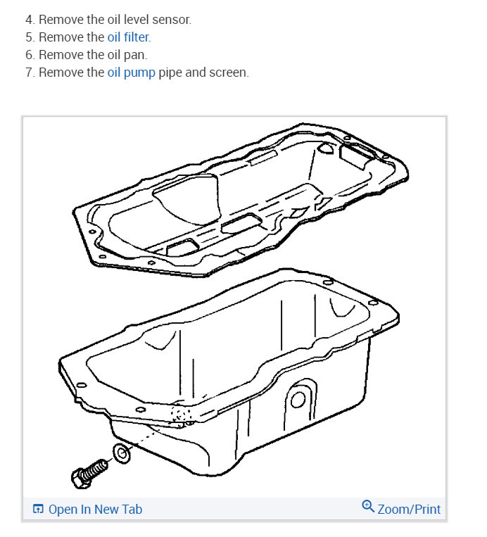

How do I remove the oil pan on a 1998 buick lesabre. Do I have to lower the pan a little and remove the pick up tube then pull the pan off completely? Is the oil pump located inside the oil pan or on the side of the engine accessed from the wheel well? Do you reccommend packing the oil pump with grease when replacing?
Sunday, May 9th, 2010 AT 6:23 AM
14 Replies
BLUELIGHTNIN6
  • 16,542 POSTS
Yes you need to lubricate the gears and fill cavities with petroleum jelly before installing pump. Have to remove the front cover and oil filter adapter, gasket, pressure regulator and valve from front cover to access pump. Here are the instruction on how to remove the oil pan in the diagrams below.

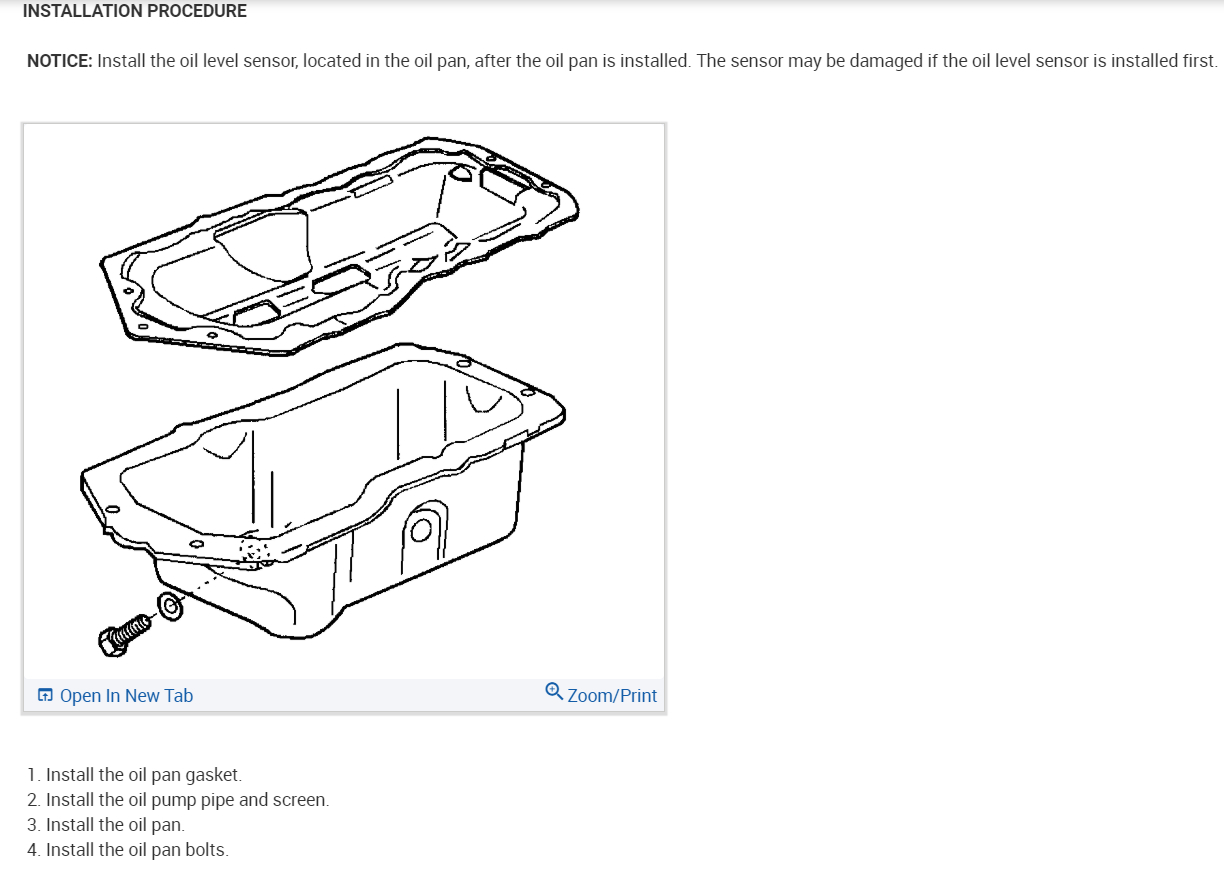

Hi there,
Instructions for sump removal.
mark (mhpautos)
https://www.2carpros.com/forum/automotive_pictures/61395_snap_1_27.jpg

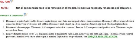

Are there any obstructions, such as pipes, brackets, etc, that have to be removed before I can drop the pan?
Monday, May 4th, 2020 AT 2:37 PM (Merged)
DOCFIXIT
  • 18,828 POSTS
Hi
Need to remove
engine torque strut
exhaust pipe
oil cooler lines
A/C compressor
engine mounts
attach trans jack raise engine remove oil pan.
Good Luck

I was under the car and don't see any of that stuff. It looks like the only thing is the cover that goes to the transmission. I can see all of the bolts holding the oil pan on, but not where that cover is. Maybe you can take another look. Re: Buick LeSabre 1995 Limited Edition 3800 engine. Thanks
+1
DOCFIXIT
  • 18,828 POSTS
GM provides generic instructions they state all models may not need removal of some items.
*Engine torque strut is on top engine looks like a dog bone
If A/C comp not covering up bolts leave it alone
*Engine mounts
*trans jack up engine
*Cover over torque converter
* must items
