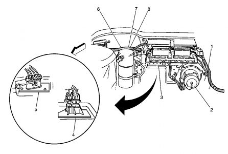

where is the blower motor resistor located my blower fan speeds are not working correctly.

xTooltipElement Service Information 1998 Buick LeSabre | Bonneville, Eighty Eight, LeSabre, LSS (VIN C/H) Service Manual | HVAC | HVAC Systems - Manual | Component Locator | Document ID: 477934 Engine Compartment, Right Rear Corner (1) S104 (2) Blower Motor (3) Blower Motor Resistor, Blower Control Module (Hidden) (4) Blower Control Module (5) Blower Motor Resistor (6) S101 (7) S103 (8) S102 © 2008 General Motors Corporation. All rights reserved.
