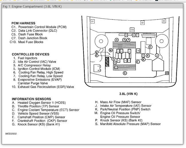

where is the radiator fan relays?
Oct 17, 2010 at 2:02 PM
  • 54,837 POSTS
Hello Chevyonlyguy,
I did some research and found this diagram for you. Check out the diagrams (Below). Please let us know what you find.

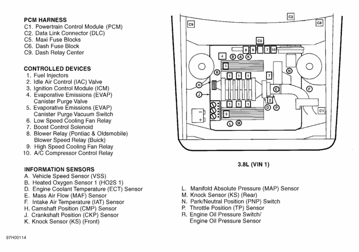

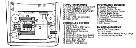

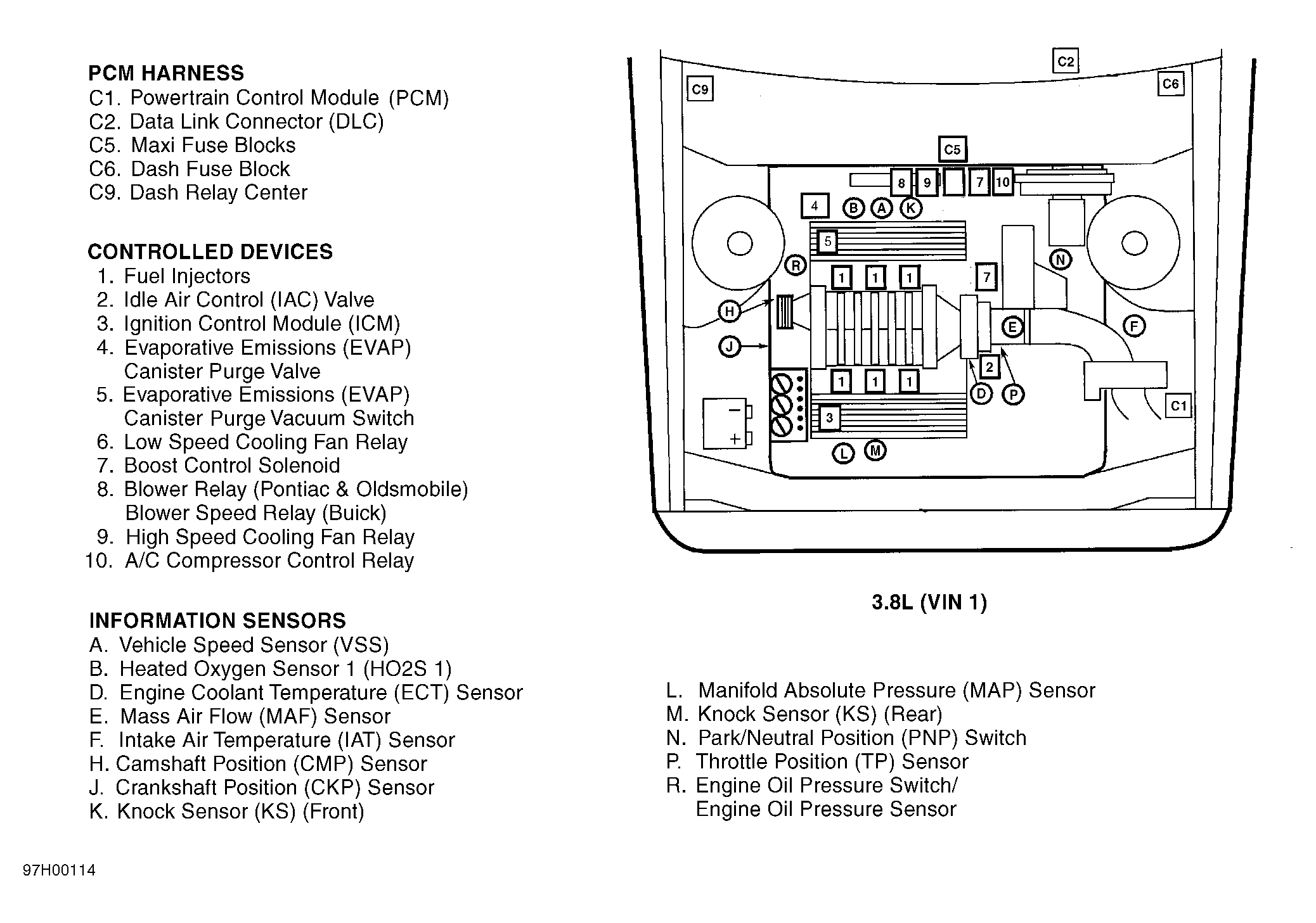

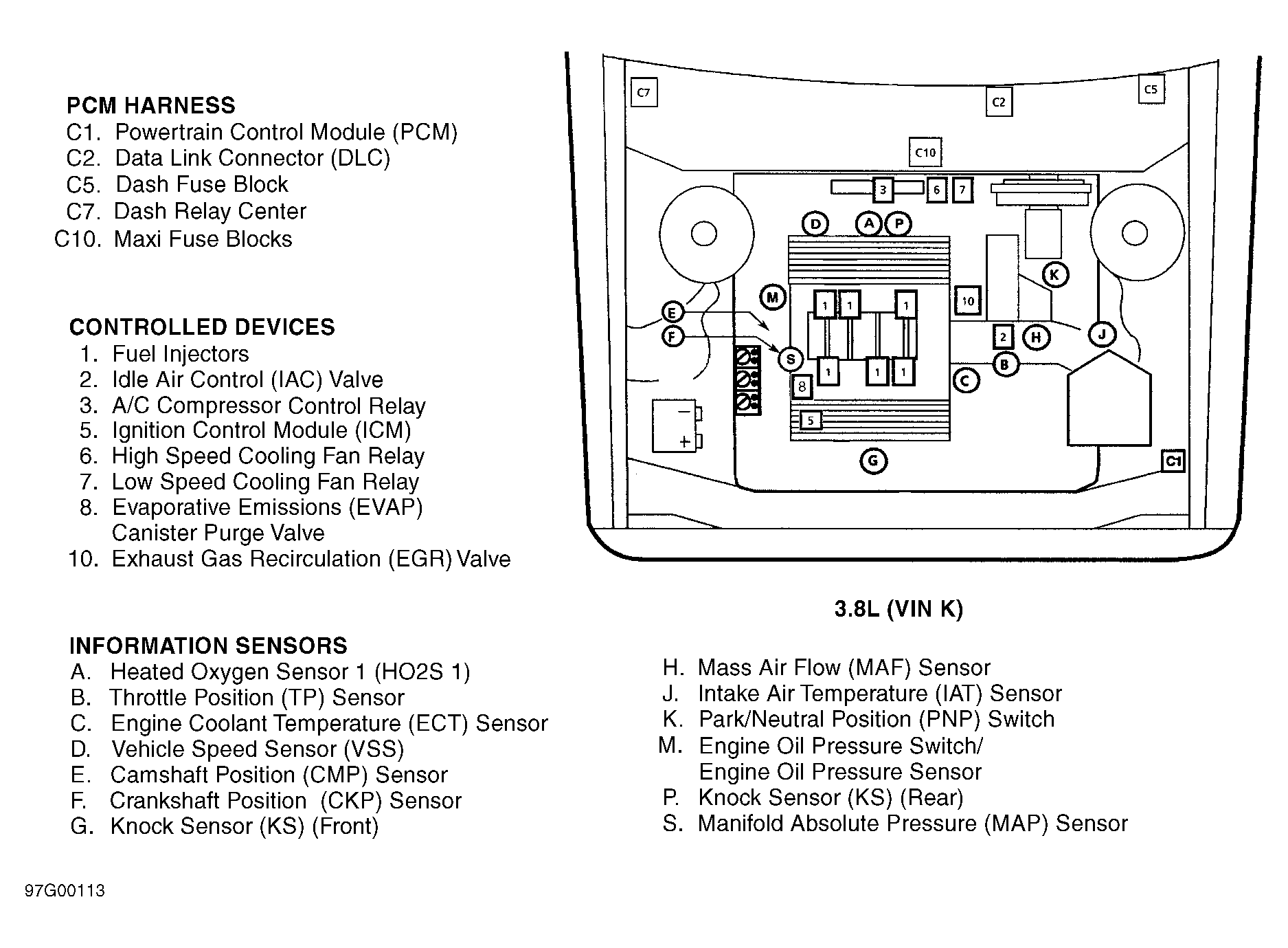

Here is a guide to help you test the (2 high and low speed 6 and 7) relays which are on the fire wall the diagrams below will show you.
Check out the diagrams (Below). Please let us know if you need anything else to get the problem fixed two options for the locations
