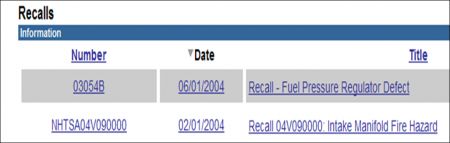

Hello Well, the error code: E13: Tape Communication Error Cause(s): The micro-processor is reading the speed pulses from the tape deck either too fast or too slow. There is always a chance of damage unless you take it to a service center and have them do it. If you want to try it yourself, I have used a small screw driver and gentle tried to lift the tape up while hitting eject. Sometimes that works. You may have to take the radio apart to get it out. I you would like I can provide info on radio removal. Looks like you may have some recalls on your vehicle. The dealer may fix these for free. Please contact the dealer service department, give them the VIN number of your car and have them check on these to see if they apply to you.
https://images.2carpros.com/forum/automotive_pictures/248015_1998_Buick_1.jpg
