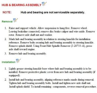

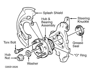

How difficult is replacing a front wheel bearing in a 1997 Buick LeSabre? What is the procedure to completing this part replacement? Thanks for any info, Dan
