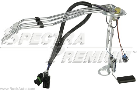

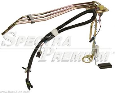

I have a 1997 buick LeSabre that has a bad sending unit. There are two different types available. One is coded as HEN/HER and the other is CRD.
How do I know which one to order? I can find nothing on line that tells me.
NAPA thought the HEN/HER would work.

They both look almost identical, but not interchangeable. HEN/HER is meant for late 1997 - 1998,
https://images.2carpros.com/forum/automotive_pictures/55316_m_fg07pHER_1.jpg
CRD is meant for 1996 - early 1997.
https://images.2carpros.com/forum/automotive_pictures/55316_m_fg07ncrd_1.jpg
You may want to check your manufacture date (should be on driver door VIN tag) for the month/year of mfg. Jan - June is considered early, July - December is late. But I would really check with your local dealership. Have your VIN number ready and ask them which fuel sending unit will work.
