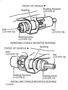

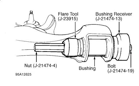

What is the cost to replace these and what would the basic steps be to do it.

@$200 a side. Remove wheel, stablizer arm, seperate ball joint and unbolt arm from frame. will need coupl special tools
