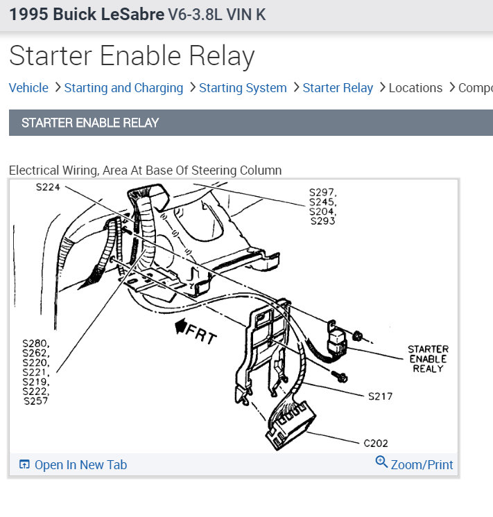

JEFFERY W
my car wont start had the starter and batttery checked all good they tell me its the starter relay the lights inside the car go dim but the head lights dont go dim
Nov 18, 2020 at 12:17 AM (Merged)
HMAC300
  • 48,601 POSTS
first if you have another key try that as the chip may be bad in your key then switch relay with a like relay to see if it's actually the relay or not.

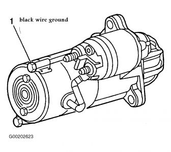

Electrical problem
1994 Buick Lesabre 6 cyl Front Wheel Drive Automatic 160k miles
Ground Wire on Starter Not stayin Hot after letting go of key after being cranked
BUDDYCRAIGG
  • 2,262 POSTS
there is no ground wire for the starter.
and the small wire (probably purple) is not supposed to have power after you let go of the key

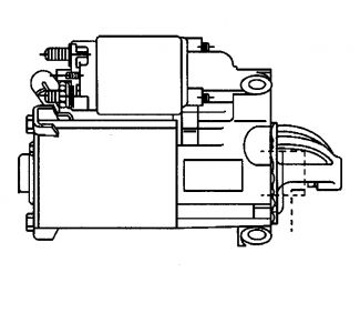

BIGIS2007
Electrical problem
1994 Buick Lesabre 6 cyl Wheel Drive Type unknown Automatic 112000 miles
when i turn my key it just does a click noise. my battery is fine. if its the starter where do i find it and how do i change it
BMRFIXIT
  • 19,053 POSTS
starter is mounted on the engine/tranny mid of car in front it looks similar to that it mount on by two bolts make sure you Disconnect the battery negative before any work starter wired straight to the battery and series damage can be caused to you or the system if wires touch ground or tools that is grounded
https://images.2carpros.com/forum/automotive_pictures/99387_starter_2.jpg
https://images.2carpros.com/forum/automotive_pictures/99387_starter_1_2.jpg

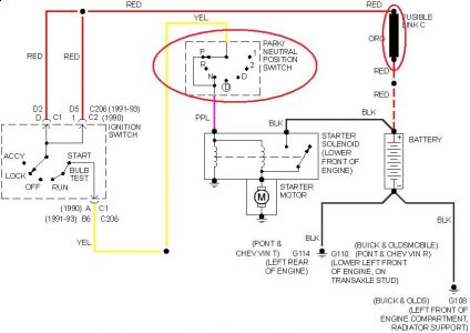

WARESINK29
Electrical problem
1993 Buick Lesabre Two Wheel Drive Automatic
i turn the key on and everything comes on in the car but when i turn it more to start it nothing happens. I have put a new starter on it but that wasn't it
Nov 18, 2020 at 12:18 AM (Merged)
ZACKMAN
  • 4,202 POSTS
https://images.2carpros.com/forum/automotive_pictures/55316_93lesabrestarter_1.jpg
You will need a voltmeter. From underneath the vehicle, probe positive to the battery and black to ground. You should have voltage. Next, probe positive wire to purple wire (ignition) and black to ground. Have someone turn the key to crank. If there is power, bench test the starter. If there is no power, check the fusible link C. If fusible link is good, move shifter out of "PARK" to "NEUTRAL", and re-test. If still no power, check your Neutral Safety Switch.
