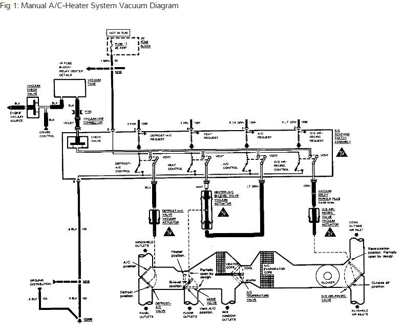

I am only getting heat out of one side of the car. The heat is coming out on the passenger side only when on defrost and heat settings. the car does not have climate control. I sometimes get no heat at all. i had to replace the water pump because it had a bad bearing. I also replaced heater hoses and thermostat. i had someone flush coolant system.

I looked at manual hvac, hope it isn't auto. I'd have to check temp door and or directional actuators. Some of these are vacuum controlled. With a fully warmed engine are the heater hoses hot. You may have to check coolant flow through the heater core.
There is temp control, if it blocks air flow across heater core, no heat. Note the hvac view.

With a fully warmed engine, confirm both heater hoses are hot and that coolant is flowing through the heater core. Also inspect the temperature door and directional actuators, which may be vacuum-controlled, because a door that blocks airflow across the heater core will prevent heat.
