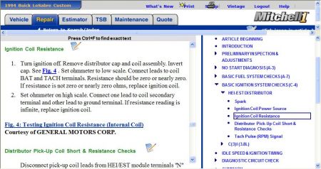

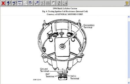

What was the coil primary and secondary windings resistances-what is the voltage on the coil's positive terminal when key at run position
Nov 9, 2008 at 11:58 PM
OLDTIMER10
Primary side is zero Ohms with continuity. Secondary's are within range.
Nov 10, 2008 at 12:10 AM
  • 75,992 POSTS

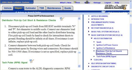

Do you have an HEI distributor or DIS See below info and also check the distributor pick-up coil
https://images.2carpros.com/forum/automotive_pictures/12900_d1_3.jpg
https://images.2carpros.com/forum/automotive_pictures/12900_d2_3.jpg
https://images.2carpros.com/forum/automotive_pictures/12900_d3_1.jpg

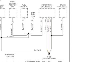

Coils have been load tested independent of engine with same weak spark. Also tested new coils with same weak spark. I believe I have a grounding problem. Can you tell me the locations of ground straps from engine to body?
thanks
Nov 10, 2008 at 10:48 AM
  • 75,992 POSTS
Check ground point G120 above the AC compressor
https://images.2carpros.com/forum/automotive_pictures/12900_pcm_ground_1.jpg
Nov 10, 2008 at 2:01 PM
OLDTIMER10
Removed wires, cleaned and applied dielectric grease at G120.
Also, checked b11-b14 with multimeter which check ok.
