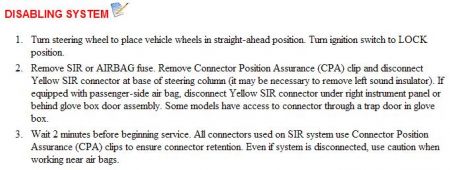

My father has a 1994 buick lesabre. He is recovering after having receiving an artificial implanted heart. His doctors tell him he is now perfectly fit to drive, except he can't drive a car with an active air bag. Can you tell me how to disable it for him? He says the local mechanic didn't know how to do it.

The instructions are below...please take caution for this repair...anytime you work around airbags there is a risk of injury.
https://images.2carpros.com/forum/automotive_pictures/261618_Noname_1213.jpg
