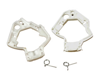

When I turn on the signal to make a left hand turn, the signal light doen't go off after making a complete turn.
It stays on until I turn it off. What can the problem be?

Quite possibly your turn signal cam is worn out and needs replacing.
https://images.2carpros.com/forum/automotive_pictures/55316_turncam_1.jpg
Located inside your steering column.
