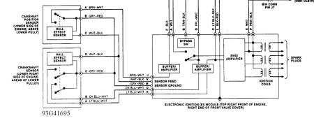

not getting any fire, have already replaced ignition/coils module, ignition crank sensor and computer

Did you check for voltage at the ignition module? Pink wire with black tracer, goes hot with the key on., fuse protected circuit.
