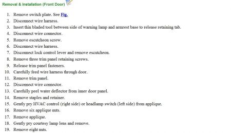

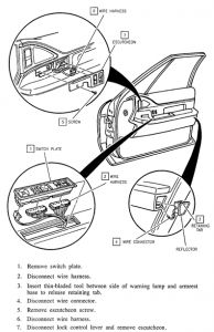

How do I remove the door panel so that I can change the headlight switch which is located on the driver's side door?
Aug 6, 2010 at 4:16 PM
BLUELIGHTNIN6
Experienced Mechanic
16,542 POSTS
Aug 7, 2010 at 4:44 AM
