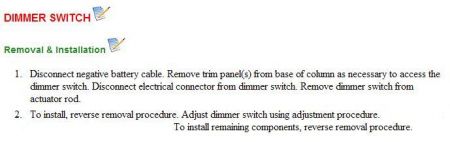

Where is headlight dimmer switch located, and how to removed it.
Monday, March 23rd, 2009 AT 11:04 AM
BLUELIGHTNIN6
MECHANIC
16,542 POSTS
Should be located near steering column..Replacement procedures are below..
