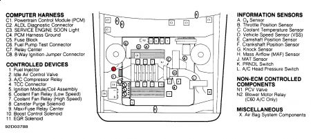

Where would the camshaft sensor be located on my 1992 Buick Lesabre?
Mar 8, 2009 at 6:35 AM
ZACKMAN
Experienced Mechanic
4,202 POSTS
On lower left side of engine, above the crank pulley.
