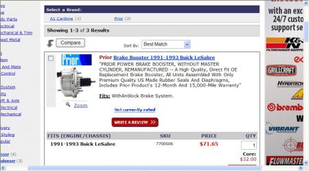

Would you happen to know the cost of the booster?
+1
Saturday, October 18th, 2008 AT 5:35 PM
  • 75,992 POSTS
About $71.65 as shown above for yours
