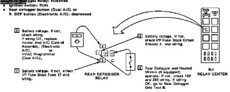

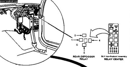

I Have a had a fire with my fuse panel and now that winter is coming up i need to hard wiure the heater so my defrost works if someone could please help me find the wiring diagram so i can figure out what i have to do that would be great
Nov 15, 2007 at 9:00 PM
BMRFIXIT
  • 19,053 POSTS
you should start with the relay here some pic hope that help good luck
