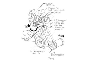

HOW TO CHANGE A BELT ON 1990 BUICK LASABRE

I'm not sure of your vin, the picture may not be correct?
https://images.2carpros.com/forum/automotive_pictures/512072_buick_lesabre_serpentine_belt_1.jpg
Use 18 mm wrech or socket, whatever works best, use bolt head on tensioner, pull up to remove tension from belt, then slip belt off pulleys.
