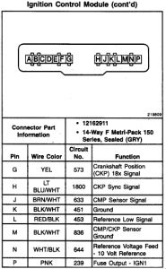

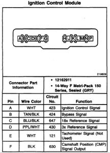

need to know which wirer is the power/12v/hot wire. or need a diagram photo
