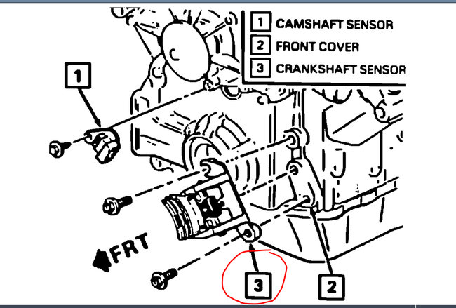

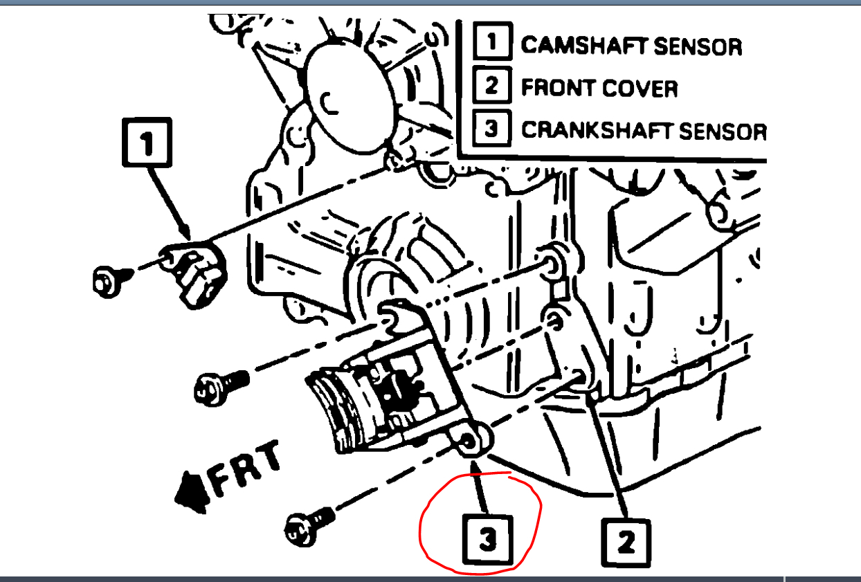

DJOYNER
Car will crank but will not start, seems to be no spark at coil pack.
Aug 4, 2020 at 9:37 AM (Merged)
  • 110,244 POSTS
Often times a failed crankshaft position sensor will cause a no spark condition. Do me a favor. I need you to pull diagnostic trouble codes on the vehicle. This has an OBD1 system and doesn't require a scanner to check. All you will need is a short jumper wire or even a paper clip.
Here is a link that shows how it is done:
https://www.2carpros.com/articles/buick-cadillac-chevy-gmc-oldsmobile-pontiac-gm-1983-1995-obd1-code-definitions-and-retrieval-method
Once you retrieve the codes, let me know what they are.
I attached a picture of the crank sensor I mentioned. Make sure it is connected and there is no damage to the wiring.
