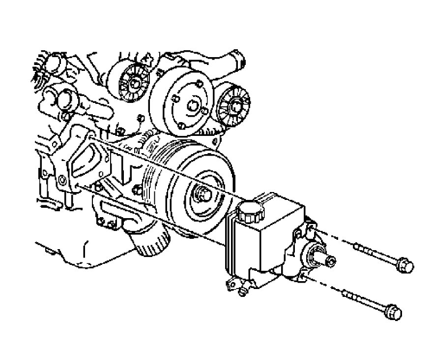

Engine Mechanical problem 6 cyl Two Wheel Drive Automatic 55000 miles
What causes a whining noise when accelerating?
This is most noticeable when outside temperatures are lower ... only notice when accelerating.
Candidate diagnoses offered by "know it all" friends are as follows:
(i) idle tensioner pulley is bad ... estimated repair $350
(ii) power steering fluid is low
(iii) power steering pump is bad ... replace
(iv) transmission is going out (don't think this is it ... same noise occurs when in neutral and engine rpm is increased)
What do you think?
Apr 24, 2010 at 7:20 AM
  • 55,224 POSTS
All of these things can make the noise but the most likely problem is the power steering pump. Here is a guide that help you see what you are in for when doing the job.
https://www.2carpros.com/articles/how-to-replace-a-power-steering-pump

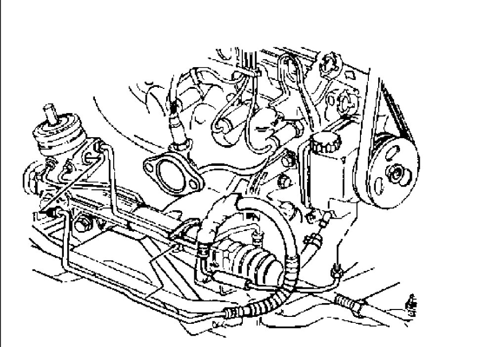

ANDREA PICKEL
I had the same issue which is why I initially Googled this awhile back. Took my car into my local mechanic and it ended up being my rack and pinion gear box was leaking. Now my car is quiet again! Repair cost on my 2010 Lacrosse total with labor was $884.36.

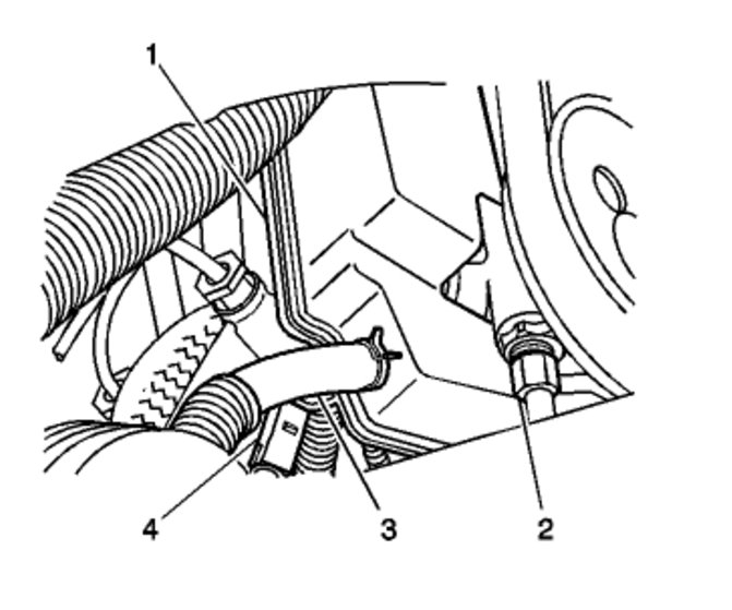

My car makes a whining sound like an airplane taking off when I accelerate. It is now starting to make the noise when I coast too. It does not make the noise when I put the car in reverse. It is quite loud all of the time. Any thoughts what could be causing it?
Aug 17, 2018 at 12:23 PM (Merged)
DOCFIXIT
  • 18,828 POSTS
This sounds is created when the transmission filter gets plugged up. Here is a guide to help you see what you are in for when changing it:
Cheers
HLACEFIELD
Thank you! My filter when plugged shifts great no noise, I love this site.
