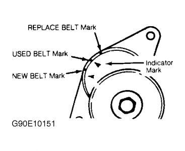

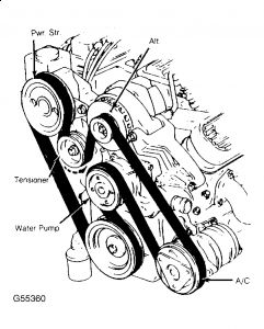

I replaced the belt now i have a lound grinding noise.It looks like my water pump wheel is wobbling,and the belt is barely staying on.How do i know for sure and is there anything you can tell me abot how to replace.Your online belt diagram was great .thanks for any help you can offer.

Hello - Thanks for the info............. If the pulley is wobbling as you say then the shaft is worn. Is there water leaking out? I would take the belt off and check by hand also. Based off of what you are saying though you need to replace it. Before you take it apart make sure you look at your belt tensioner. Automatic tensioners have a belt-wear indicator. See Fig. 2 . If tensioner reaches its travel limit, indicated by marks on tensioner, belt should be replaced. If a whining or grinding noise is heard from tensioner or idler pulley, check for possible bearing failure.

One the belt is off also check all of the other pulley wheels for freedom of movement, noise etc.
