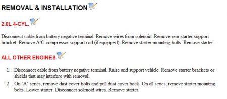

how do i get the starter out

https://images.2carpros.com/forum/automotive_pictures/261618_Noname_1609.jpg
