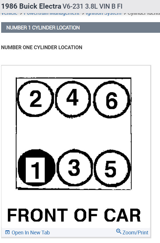

hi i took all of my plug wires of of my 1986 buick electra and i don't know where the go now i don't get just the firing order numbers i need a picture or diagram please.

If you look at the top of the coils,each coil is numbered for its corresponding cylinder,Cylinders #1#3 #5 are in the front (radiator side),Cylinders #4#5#6 are at the firewall side.Cylinder #1 will be the one closest to the pulleys(belt).
Firing Order .................... 1-6-5-4-3-2
Check out the images (Below). Please let us know if you need anything else to get the problem fixed. Good Luck,Lou

the coils are not numbered, firewall side cylinders are what?

the firewall side is #2,4 and 6.
