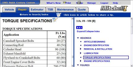

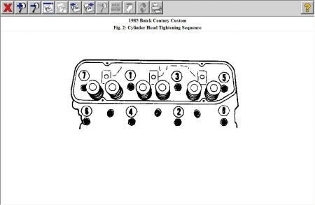

I need the head bolt torque specs for a 1982 Buick Century with a 3.0 V6 engine if anyone can help, thank you.
Nov 9, 2007 at 7:15 AM
  • 75,988 POSTS
Headbolt torques> 90ft lbs
