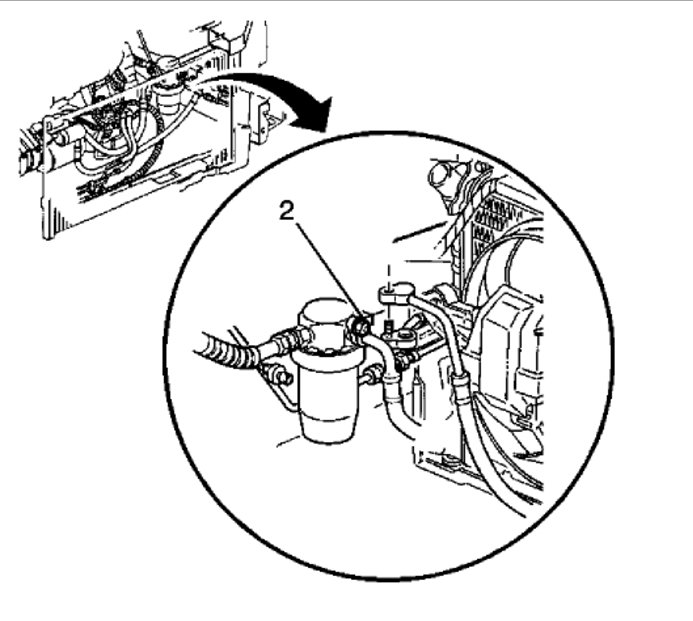

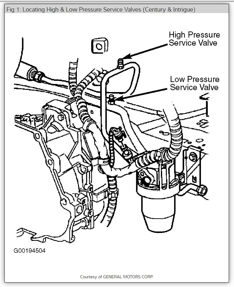

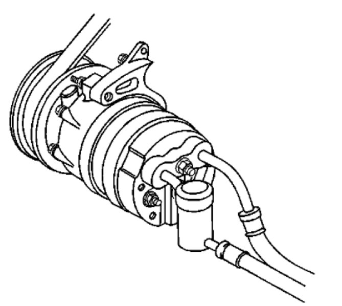

I need to know where the low pressure recharge port is located on my 2002 Buick Century - sketch or photo showing location?

We got you covered, I found these diagrams (below) and guide for you please let us know if you need anything else.
https://www.2carpros.com/articles/air-conditioner-how-to-add-freon
Best, KenCheck out the diagrams (Below). Please let us know if you need anything else to get the problem fixed.
