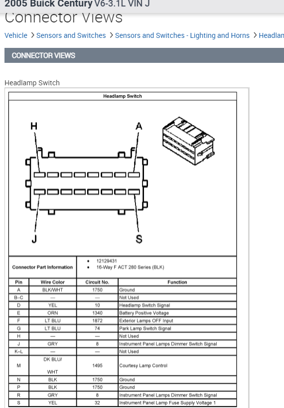

My head lights have gone off when I attempt to change from low beams to high beams and sometimes the lights have just gone off while I have been driving.

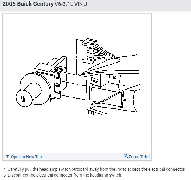

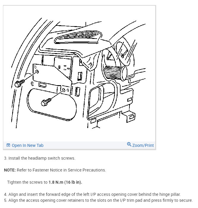

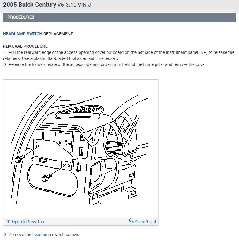

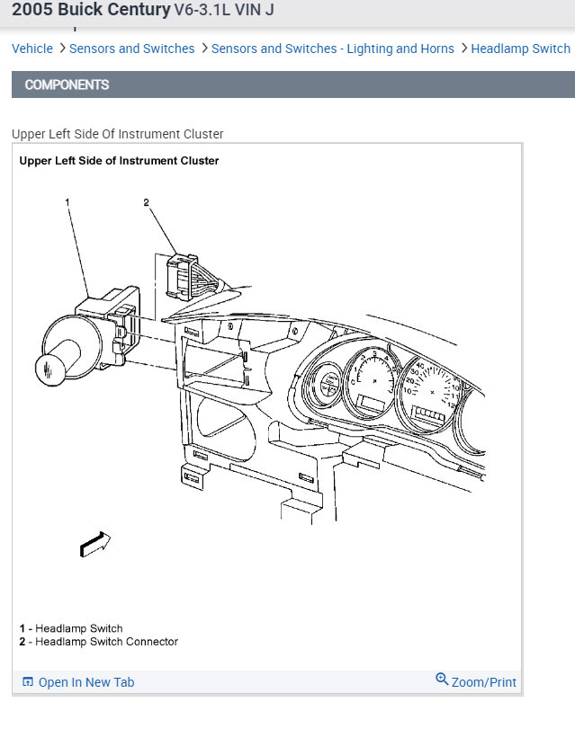

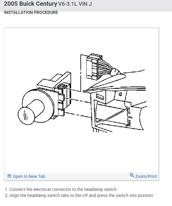

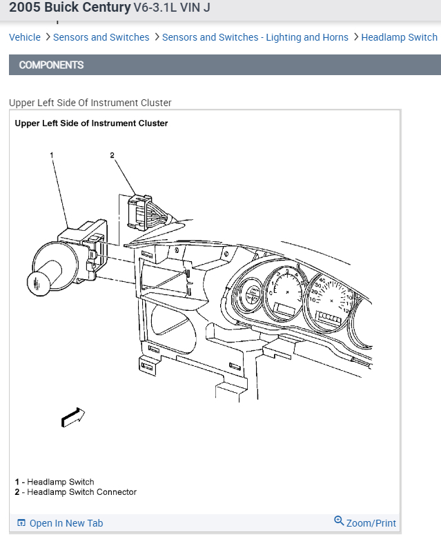

It sounds like you might have a faulty headlight switch.
It is possible that you have corrosion or loose connection within the switch due to wear and tear.
Here is a helpful article:
https://www.2carpros.com/articles/how-a-headlight-switch-works

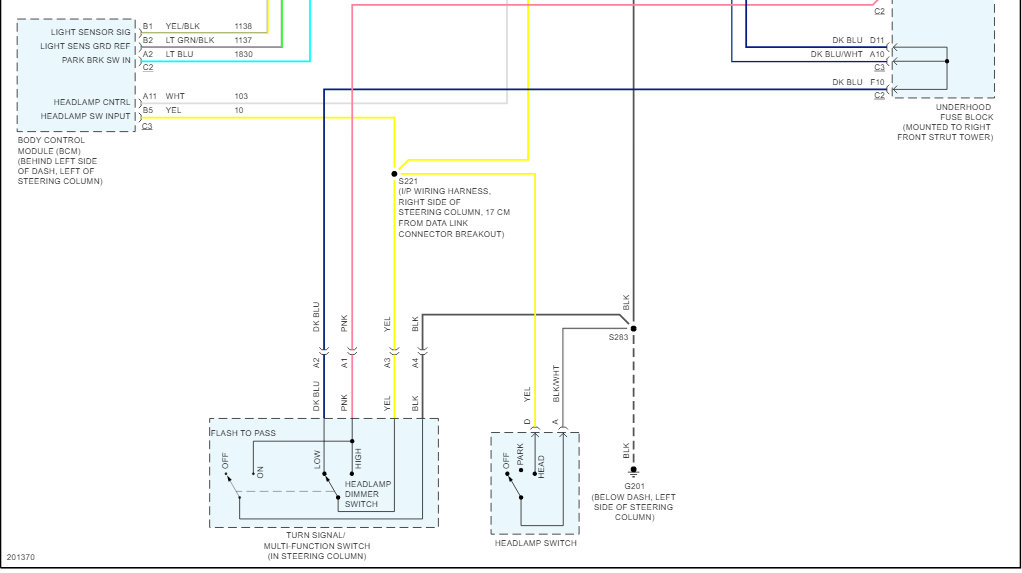

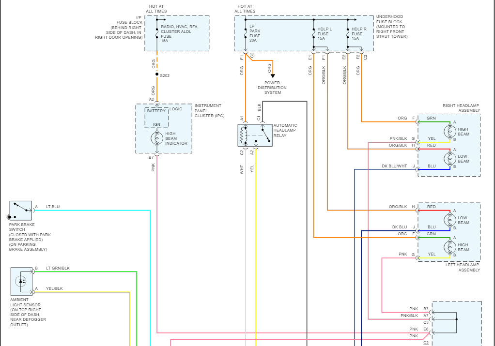

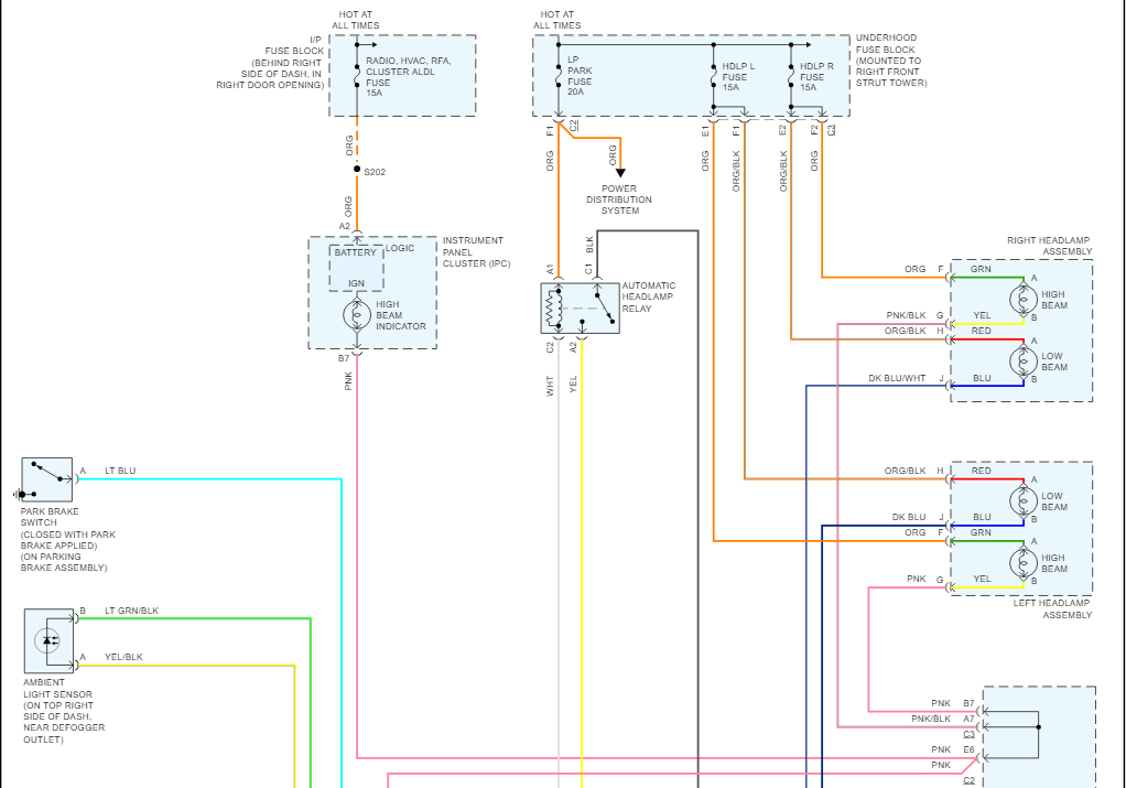

It can also be due to a bad ground that the lights are just going off. In which you will have to trace the wires to find the issue. I have included the wiring schematics below.
I have attached the diagrams for your reference.
