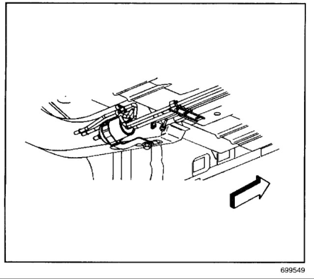

Could you please tell me where the fuel filter is located?
2005 BUICK CENTURY
61,000 MILES • 6 CYL • FWD • AUTOMATIC
SEMOED
Thanks
Feb 17, 2009 at 12:22 PM
JDL
  • 16,098 POSTS
Hello, check underneath at the rear, may be on driver side.
https://images.2carpros.com/forum/automotive_pictures/170934_2005_1.jpg

Under vehicle, driver side, below seating area, front of fuel tank, mounted on frame rail in fuel line. Here is a guide to help you change it out.

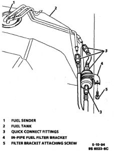

  • 75,992 POSTS
The fuel filter is located on the fuel feed pipe, between the fuel pump and the fuel injectors. The paper filter element (2) traps particles in the fuel that may damage the fuel injection system. The filter housing (1) is made to withstand maximum fuel system pressure, exposure to fuel additives, and changes in temperature. There is no service interval for fuel filter replacement. Replace a restricted fuel filter
https://images.2carpros.com/forum/automotive_pictures/12900_ff_18.jpg

The fuel filter is located in the fuel feed line attached to the underbody, directly in front of the fuel tank.
https://images.2carpros.com/forum/automotive_pictures/261618_0900c1528021796a_1.jpg

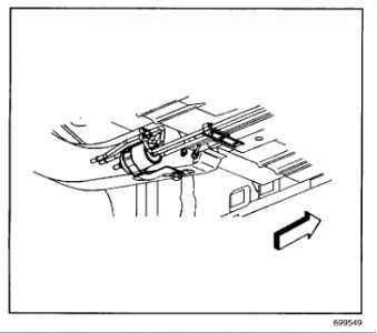

R1CH2369
Engine Mechanical problem
1998 Buick Century 6 cyl Two Wheel Drive Automatic
were is the fuel filter located
Jul 1, 2019 at 5:19 PM (Merged)
  • 75,992 POSTS
Fuel Filter Mounting
https://images.2carpros.com/forum/automotive_pictures/12900_filter_1.jpg
The filter is mounted near the fuel tank on the left side frame rail.

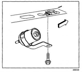

REMOVAL PROCEDURE
https://images.2carpros.com/forum/automotive_pictures/12900_ff_13.gif
Relieve the fuel system pressure. Refer to Fuel Pressure Relief Procedure. NOTE: Refer to Cover and Plug Openings Notice in Service Precautions. IMPORTANT: Always maintain cleanliness when servicing fuel system components. Raise and support the vehicle. Refer to Lifting and Jacking the Vehicle. Disconnect the quick-connect fitting at the inlet of the fuel filter. Remove the threaded nut fitting at the outlet of the fuel filter. Drain any remaining fuel into an approved gasoline container.
https://images.2carpros.com/forum/automotive_pictures/12900_ff1_9.jpg
Remove the fuel filter mounting bracket bolt. Remove the fuel filter and the mounting bracket. Remove the fuel filter from the fuel filter mounting bracket. INSTALLATION PROCEDURE
Remove the protective caps from the new fuel filter. IMPORTANT: There is not a service interval for fuel filter replacement. Only replace the fuel filter if the filter is restricted. Install the fuel filter to the fuel filter mounting bracket. Install the fuel filter and the mounting bracket. Install the fuel filter mounting bracket bolt. NOTE: Refer to Fastener Notice in Caution and Notices. Tighten Tighten the bolt to 20 N.m (15 lb ft).
