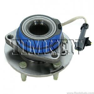

The check engine light/anti-lock comes on and the low tack light from the right side also comes on. Sometimes its on when I start the car other times it comes on when I am backing out of a parking spot turning the wheel. I have new tires that have been on for 2 months

have to check for codes suspect bad hub bearing and or wire check ABS sensor by the wheel
https://images.2carpros.com/forum/automotive_pictures/99387_1_18.jpg
