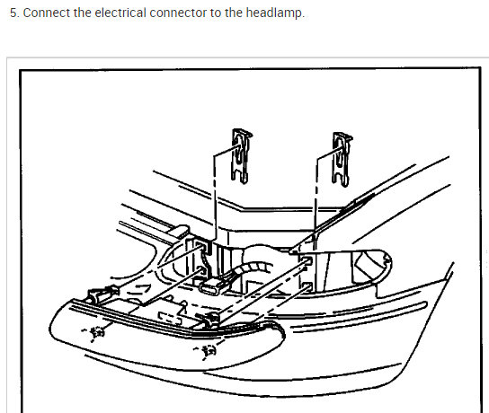

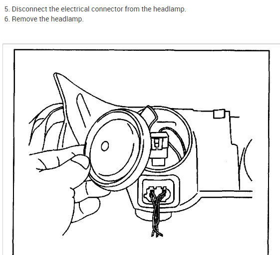

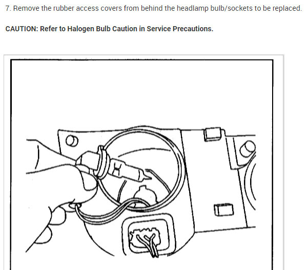

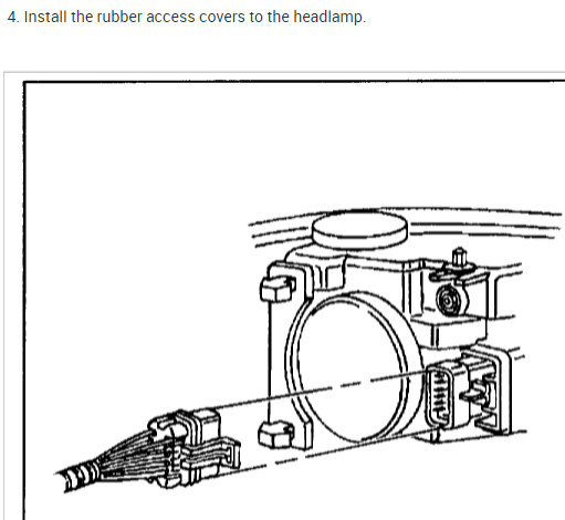

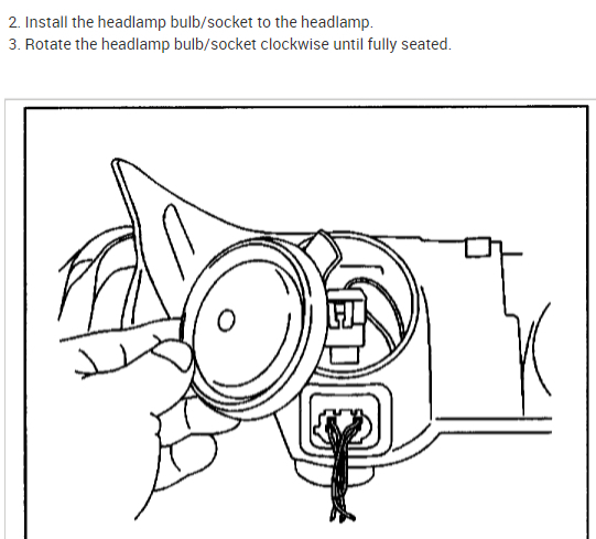

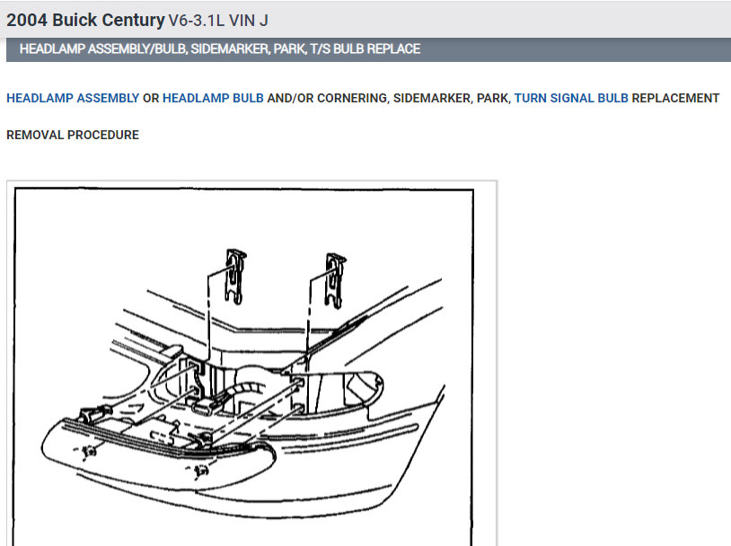

How do you change the Turn Signal bulb for the front? Thanks John Godfrey
Dec 13, 2007 at 12:08 AM
DANNY L
Experienced Mechanic
5,648 POSTS
Hello, I'm Danny.

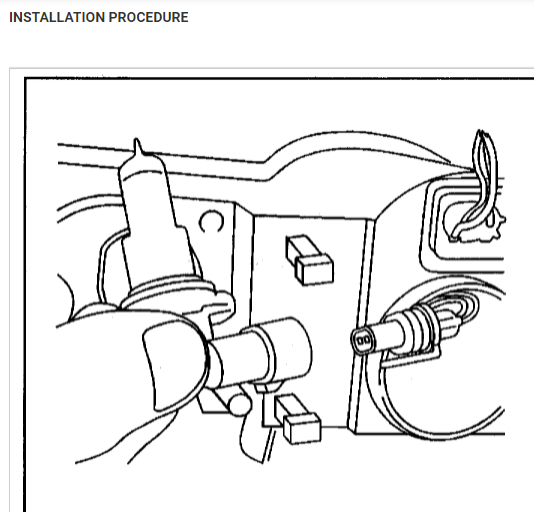

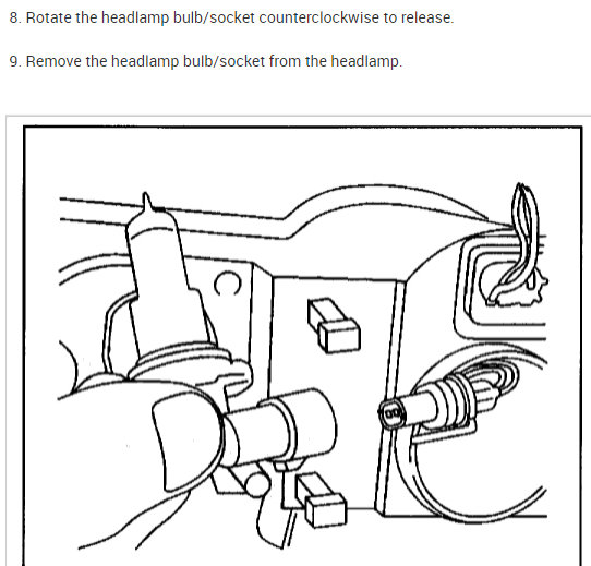

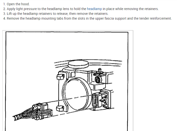

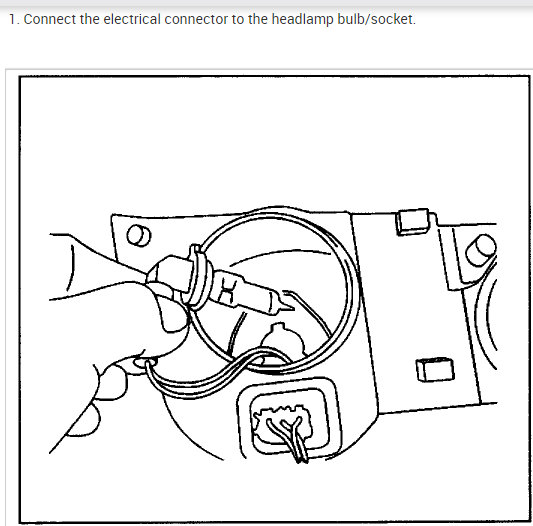

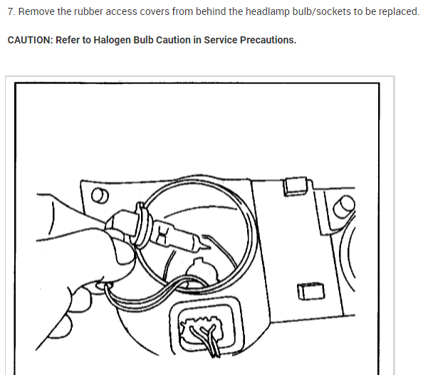

Here is the information you requested. This is a tutorial for you on how to change a turn signal bulb:
https://www.2carpros.com/articles/turn-signal-bulb-replacement
I've attached picture steps below on how to remove and replace the turn signal bulb on your car. Hope this helps and thanks for using 2CarPros.
Images (Click to enlarge)
