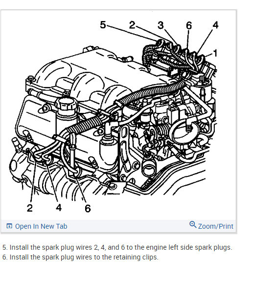

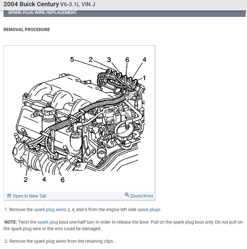

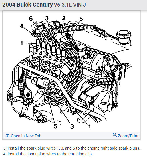

I have tried to pull these puppies off and they are adhered really good. I pulled a front one off using pliers and twisting but that might buggers up the boots in the back due to lack of space. Any hints???
May 19, 2010 at 2:15 PM
SQM
  • 6,383 POSTS

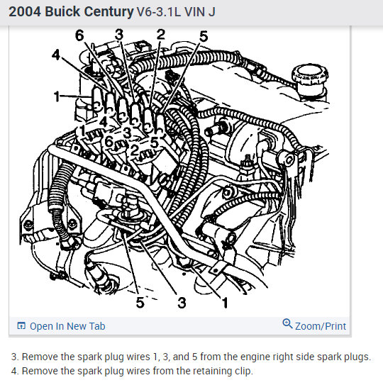

The back wires are little tricky to get out due to lack of room.

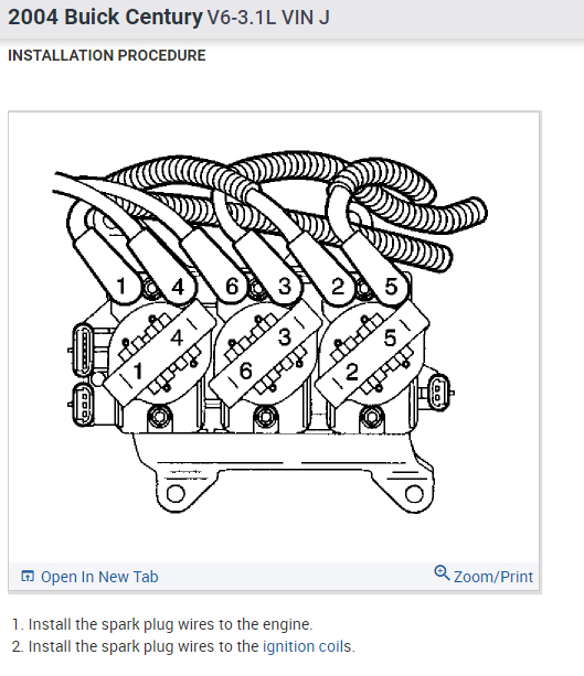

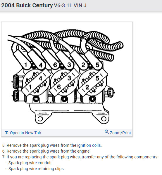

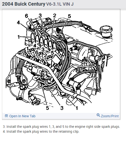

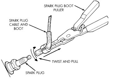

Try using a spark plug wire removal tool (see diagram below). It can make it a little easier. You will still have little room to work with but it can help will pulling out the wires without damaging them.
Here is a helpful video:
https://youtu.be/b75Zwl4qVuc
I have included the replacement procedure for your reference.
