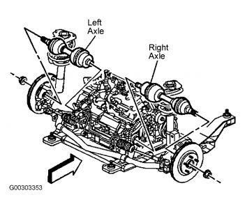

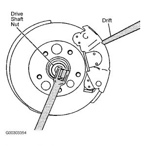

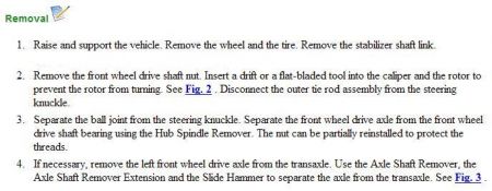

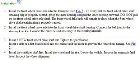

Ineed to replace the left shaft & cv assembly. How are these held in? Do I just pull them out, and slide them back in, or is there something else I should I know ?
Sep 13, 2009 at 9:43 AM
BLUELIGHTNIN6
  • 16,542 POSTS
Special service tools are needed for this repair, procedures are below..
https://images.2carpros.com/forum/automotive_pictures/261618_Noname_953.jpg
https://images.2carpros.com/forum/automotive_pictures/261618_Noname2_261.jpg
FIG. 2
https://images.2carpros.com/forum/automotive_pictures/261618_2_62.jpg
FIG. 3
https://images.2carpros.com/forum/automotive_pictures/261618_3_27.jpg
