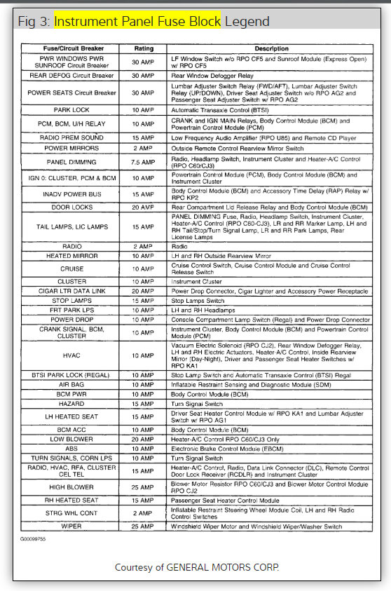

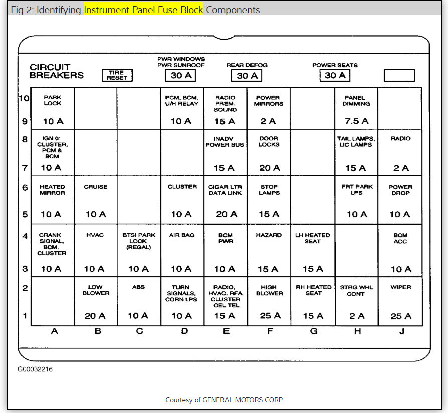

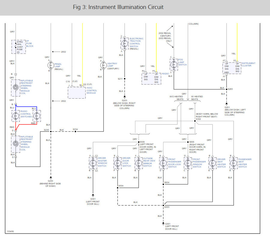

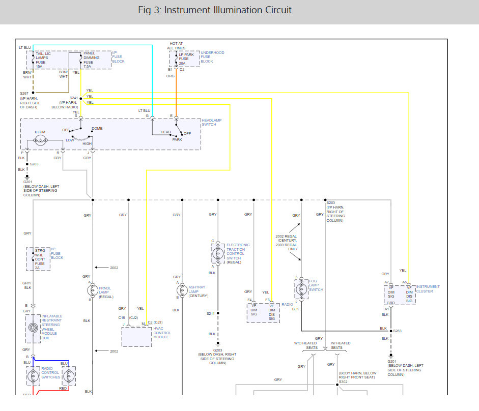

The light on my odometer quit working about 3 weeks ago. Don't know why. Any help will be appreciated. Thanks
Sep 3, 2009 at 7:42 AM

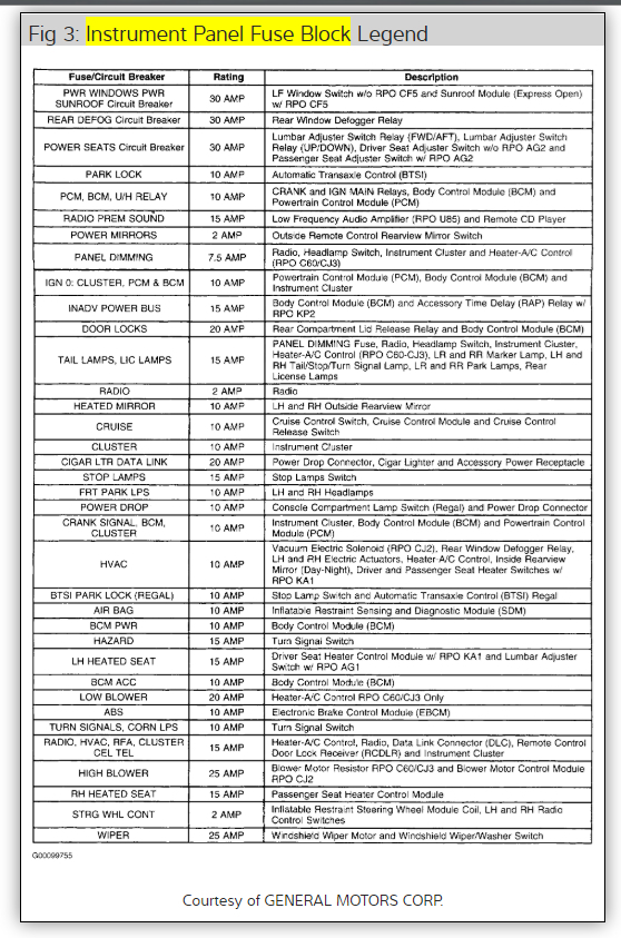

IMPALASS
  • 3,112 POSTS

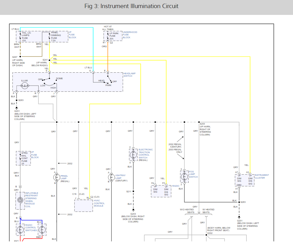

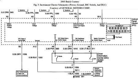

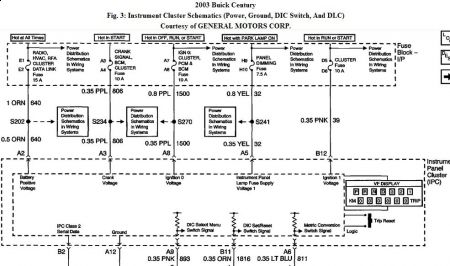

there is a panel dimmer fuse that needs to be check for power here is a guide t ehlp you with the fuse lotion in the diagrams below I also included the wiring diagrams so you can see how the system works.
Check out the diagrams (Below). Let us know what happens and please upload pictures or videos of the problem.
Sep 4, 2009 at 7:04 AM
JDARON57
The cluster was bad I got a new one it fixed it fyi.

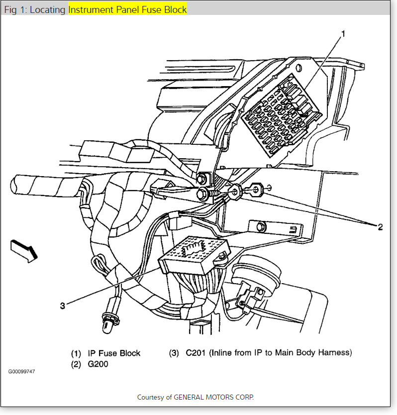

KHLOW2008
  • 41,814 POSTS
Hi Jim, Thank you for the donation. The fuse for the panel lights is the panel dimming fuse located in instrument panel fuse box. Check the fuse first. To replace the bulbs requires a lot of data and if it is required, let me know and I wll get it for you.
https://images.2carpros.com/forum/automotive_pictures/192750_InstrumentClusterSchematic03Century01_1.jpg
https://images.2carpros.com/forum/automotive_pictures/192750_InstrumentClusterSchematic03Century02_1.jpg

JASHAR369
  • 5 POSTS
You answered "on the end of right side dash" Is it close to the glove box? Passenger side? Or is it at the drivers side? I need more clues.
Mar 22, 2021 at 11:30 AM (Merged)
JASHAR369
  • 5 POSTS
I checked the 10A fuse in position Column 4 from left, Row 5 from bottom. The fuse is ok.

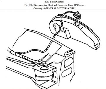

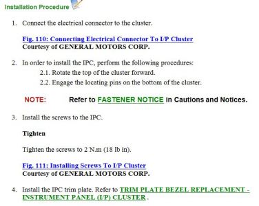

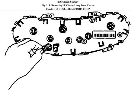

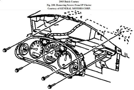

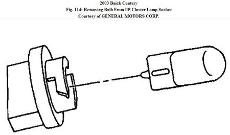

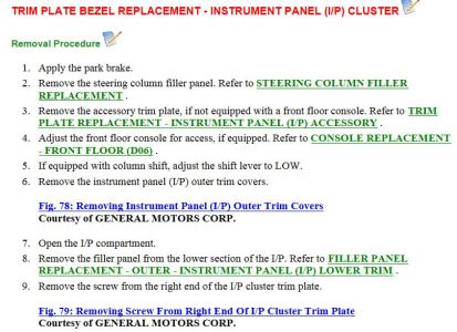

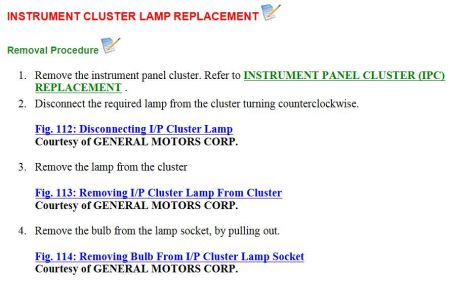

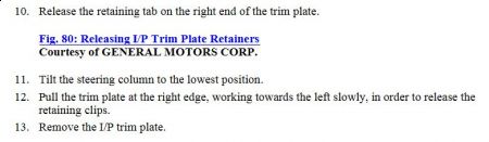

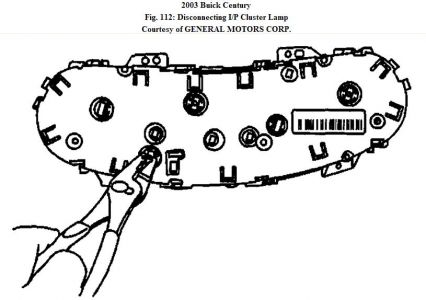

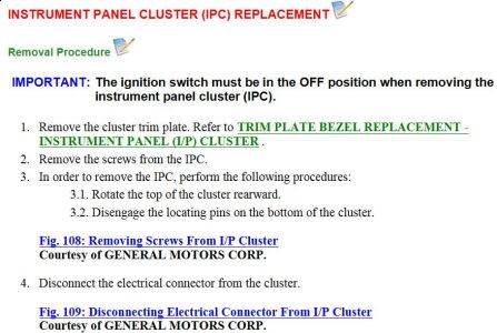

Guess the light bulbs are faulty. Here are the replacement procedures.
https://images.2carpros.com/forum/automotive_pictures/192750_InstrumentClusterLamp03Century01_1.jpg
https://images.2carpros.com/forum/automotive_pictures/192750_InstrumentClusterLamp03CenturyFig112_1.jpg
https://images.2carpros.com/forum/automotive_pictures/192750_InstrumentClusterLamp03CenturyFig113_1.jpg
https://images.2carpros.com/forum/automotive_pictures/192750_InstrumentClusterLamp03CenturyFig114_1.jpg
https://images.2carpros.com/forum/automotive_pictures/192750_IPCReplacement03Century0a1_1.jpg
https://images.2carpros.com/forum/automotive_pictures/192750_IPCReplacement03Century0a2_1.jpg
https://images.2carpros.com/forum/automotive_pictures/192750_IPCReplacement03Century01_1.jpg
https://images.2carpros.com/forum/automotive_pictures/192750_IPCReplacement03Century02_1.jpg
https://images.2carpros.com/forum/automotive_pictures/192750_IPCReplacement03CenturyFig108_1.jpg
https://images.2carpros.com/forum/automotive_pictures/192750_IPCReplacement03CenturyFig109_1.jpg

I just opened up my 2001 Buick Century for the same problem. I think the 2002 is almost identical, so this probably applies to you. It turns out the instrument cluster is one large module. Most of the warning lights are LED's, the constant-on and dimming lights are incandescent bulbs, but the odometer and gear indicator display is an LCD. If it is not lighting up, it is a module. There is no back light to replace. When I got down to mine, I could see the location of a burn-out on the LCD. It is possible the same happened to yours. I was hoping to replace just some back light bulb but it is just not possible.
I have not found any reputable dealers with instrument clusters for sale, though there were a few on eBay. I do not know if I want to put those into my car though. I am just going to call up a dealer and see how much it will cost to have them install a new module. (Probably too much, but I am kind of over a barrel on this.)
Good luck

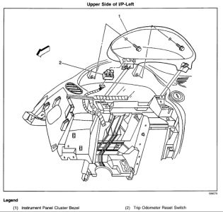

Hello - On the floor shift model the bulb is easy to get to and replace. If yours is in the cluster with the odometer, then you will have to remove the cluster to get to the back. I don't show on this model.......so you will have to look. Some are twist in bulbs and easier to remove and replace. Some are soldered into the board so you will have to look. Sorry.... To remove the cluster, remove the bezel then the cluster and look the back. You can also contact the parts department and they can check the item bulb number and be able to tell you. That way you can already have several bulbs on hand for when you pull the cluster out.
https://images.2carpros.com/forum/automotive_pictures/248015_Bezel_1.jpg
