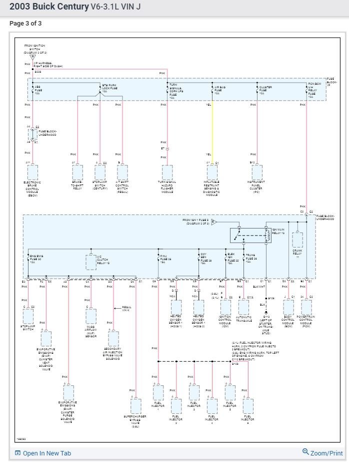

I have no back-up lights or license plate lights or inner taillights in the trunk lid. What do I do? Thanks for any help.

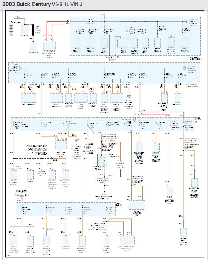

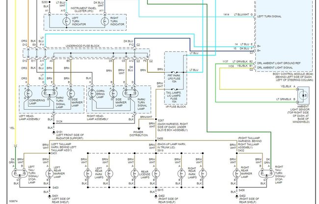

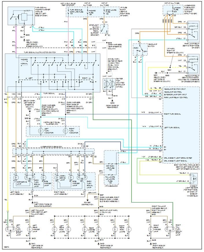

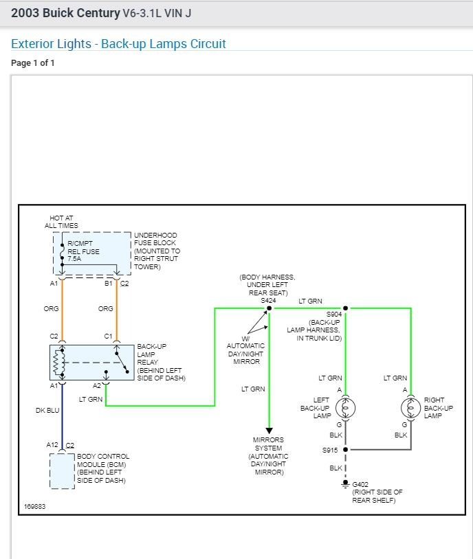

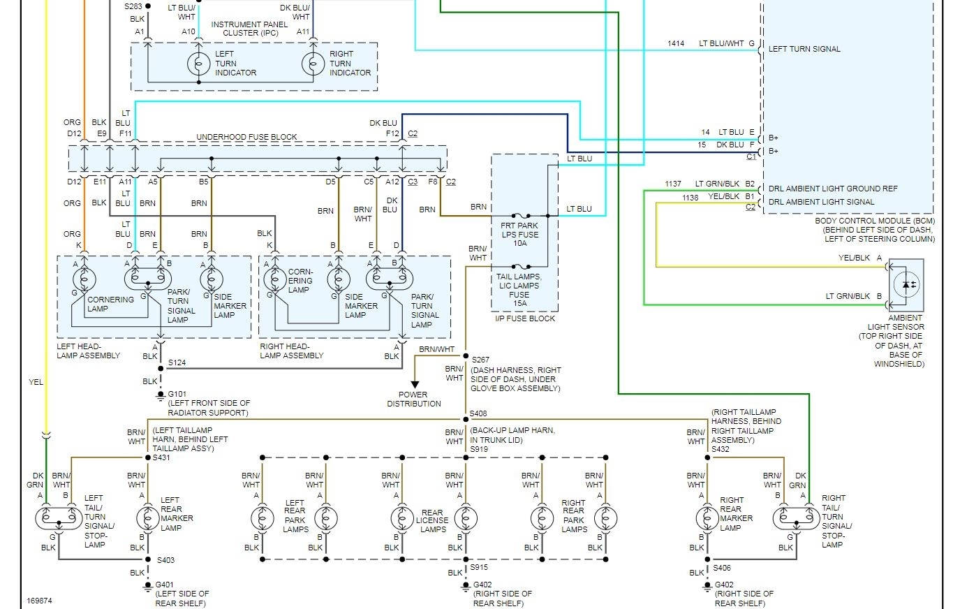

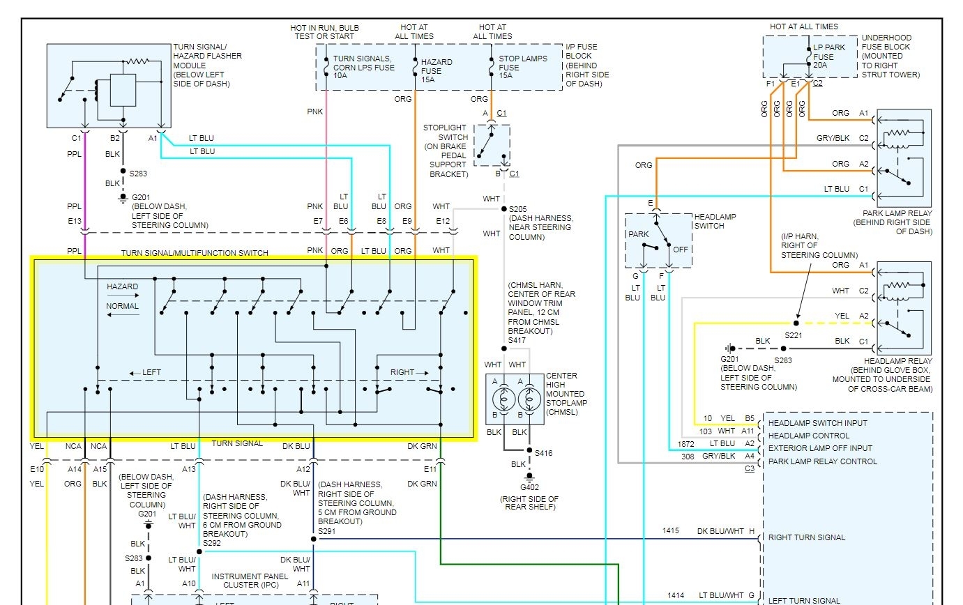

It looks like they all share a ground in the trunk and a fuse in the interior fuse block and another in the fuse block under the hood.
Use a test light to see if the fuse is blown, there is a guide below on how to do it as well as the wiring diagrams for the lights that are out
