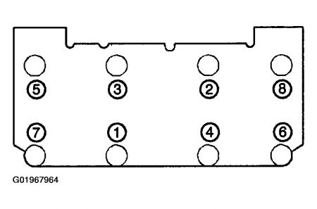

The head gasket is leaking quite badly, i need to know how to fix it. Can you help with this in providing the necessary schematics to do this job? Or suggest what to do.

this engine is a v6 and there are two head gaskets(recommend to replace both ) tools required for this repair (multiple tools and torque wrench and torque angle wrench) it also required a automotive machine shop to surface the cylinder heads.

1. Install a new left cylinder head gasket.
2. Install the left cylinder head over the locator pins and the gasket.
3. Install the new cylinder head bolts.
3.1. Tighten the bolts in sequence to 60 Nm (44 ft. lbs.).
3.2. Use the J 36660-A to rotate the cylinder head bolts in sequence an additional 95 degrees.

Cylinder Head Bolt
First Pass .................... 60 Nm 44 ft. lbs.
Final Pass .................... 95 degrees
