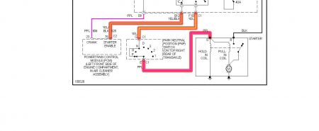

2003 Buick Century car won't start battery and starter test
44,000 MILES • 6 CYL • FWD • AUTOMATIC
BBJENSEN

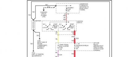

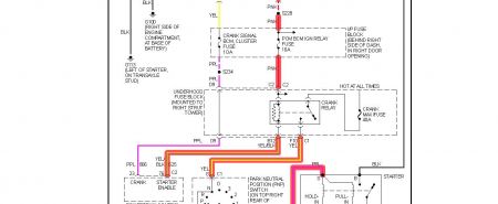

Please tell me what else I can do to get it to start.
battery has 12 volts starter never clicks.
Jul 25, 2010 at 11:12 AM
  • 75,988 POSTS
Have helper hold key at starting position tap on the starter motor and see if it 'll crank engine over-if not see below start EWD check everything below
https://images.2carpros.com/forum/automotive_pictures/12900_c1_39.jpg
https://images.2carpros.com/forum/automotive_pictures/12900_c2_32.jpg
https://images.2carpros.com/forum/automotive_pictures/12900_c3_12.jpg
