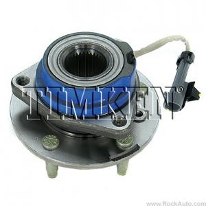

abs comes on here and there, also sometimes traction. is the wheel speed sensor part of the hub? where is it located

Sensors is a part of the wheel bearing and hub assembly
very common issue
inspect wires at the inner wheel bearing and hub
