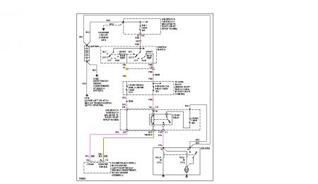

2003 Buick Century 130598 miles
WELL MY CAR STILL WONT DO ANYTHING EXCEPT CLICK WHEN I TURN THE KEY.I CHANGED THE BATTERY, THE STARTER AND CHECK WIRES FOR CORROSION. I ALSO CHECK THE CRANK FUSE AND CRANK RELAY LIKE YOU GUYS INSISTED. THE SECURITY LIGHT IS NOT FLASHING OR ON. I BYPASSED IT(PASSKEY SECURITY) ANYWAY JUST TO SEE IF THAT WAS IT AND STILL ALL I GET IS ONE CLICK OUT OF THE STARTER. SO I DONT THINK ITS A SECURITY ISSUE. IM TIRED OF ASKING PEOPLE TO DRIVE ME TO WORK I NEED HELP BAD!!!!!! WHAT ELSE COULD IT BE...
Oct 25, 2010 at 8:20 PM
HMAC300
  • 48,601 POSTS
i am sending the wiring diagram for your car for starting. there is a 40 amp fuse that is by the relay , it is clearly marked on the diagram.it may be that your starter is not getting the enable part to make it turn over. this is clearly marked as well on the diagram. You may have a bad or poor connection causing the problem going to the either the relay or one of the fuses......as we can't diagnose it without physically seeing it this is about the best that can be done. this should help you out immensly. or if you take it someplace take the diagram with you....
