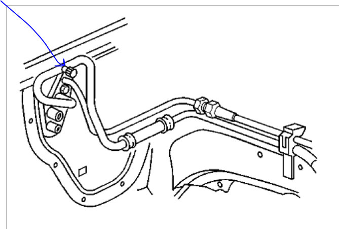

I just want to confirm that the low port for an ac recharge for my buick century is on the back wall center right

Here is video that shows how to find the low side fitting and a guide to help as well with diagrams below.
https://youtu.be/uZrQCGwXfek
and
https://www.2carpros.com/articles/air-conditioner-how-to-add-freon
Cheers
