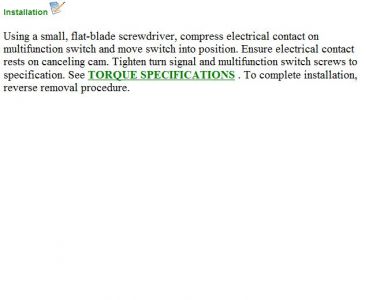

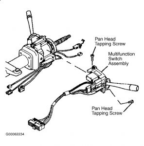

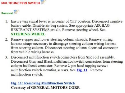

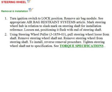

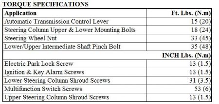

https://images.2carpros.com/forum/automotive_pictures/55316_03centurymulti1_1.jpg
https://images.2carpros.com/forum/automotive_pictures/55316_03centuryfigure12_1.jpg
https://images.2carpros.com/forum/automotive_pictures/55316_03centurymulti2_1.jpg
https://images.2carpros.com/forum/automotive_pictures/55316_03centurysteeringwheel1_1.jpg
https://images.2carpros.com/forum/automotive_pictures/55316_03centurysteeringwheel2_1.jpg

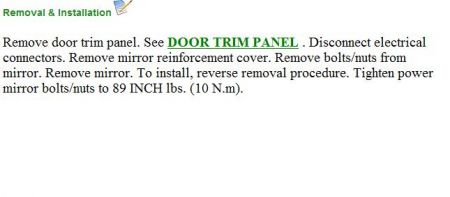

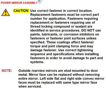

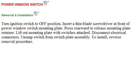

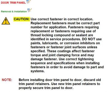

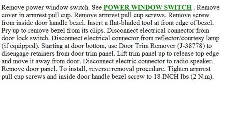

https://images.2carpros.com/forum/automotive_pictures/55316_03centurymirror1_1.jpg
https://images.2carpros.com/forum/automotive_pictures/55316_03centurymirror2_1.jpg
https://images.2carpros.com/forum/automotive_pictures/55316_03centurytrimpanel1_1.jpg
https://images.2carpros.com/forum/automotive_pictures/55316_03centurytrimpanel2_1.jpg
https://images.2carpros.com/forum/automotive_pictures/55316_03centurypw_1.jpg
