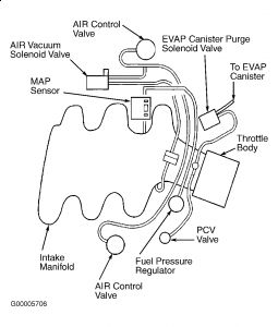

2002 Buick Century 6 cyl Two Wheel Drive Automatic
I changed the thermostat in my 2002 Buick Century. I inadvertently broke a nipple on a part and I don't know what the name of the part is so that I can buy it. It is located on the left side of the engine, to the rear of the throttle body. It has two vacuum lines attached and an electrical plug. One of the vacuum lines goes to the PCV valve.The part is square shaped and slides down on a bracket that is mounted to the manifold. You will notice there is JB weld on the part but I doubt it will work.
[img:e689e5dde6]http://www.2carpros.com/forum/automotive_pictures/454904_2002_buick_century_part_1_1.jpg[/img:e689e5dde6]

That would be the Evap Emissions Canister Purge Solenoid
https://images.2carpros.com/forum/automotive_pictures/198357_Graphic_290.jpg
