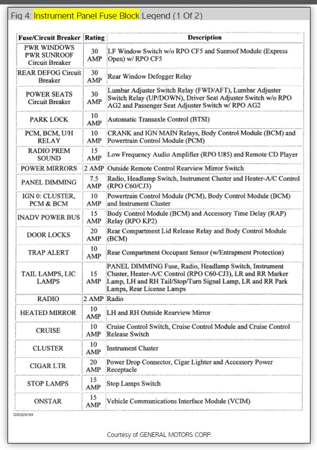

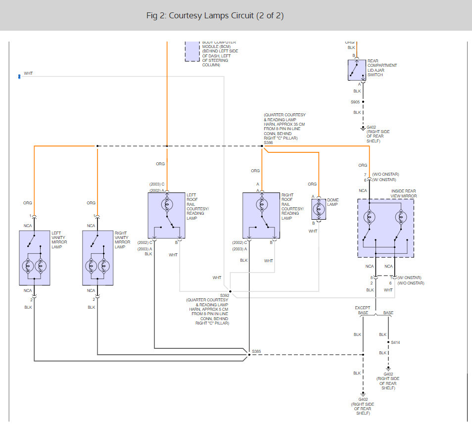

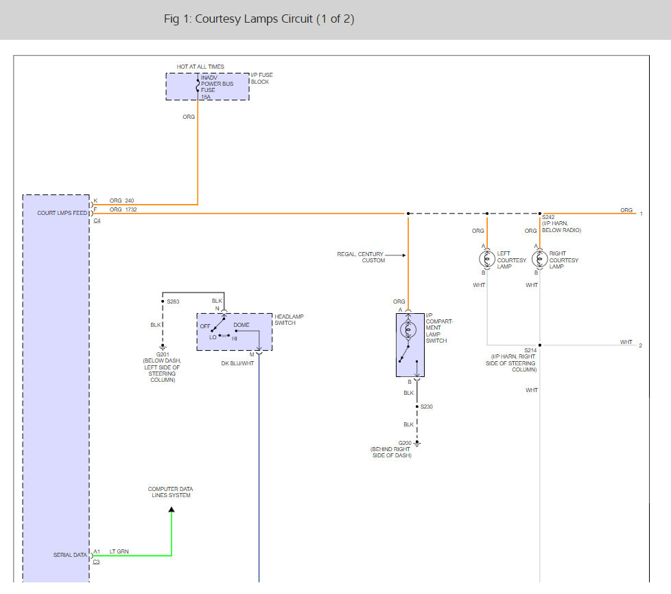

Interior problem 6 cyl Front Wheel Drive Automatic 110000 miles

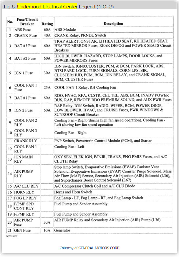

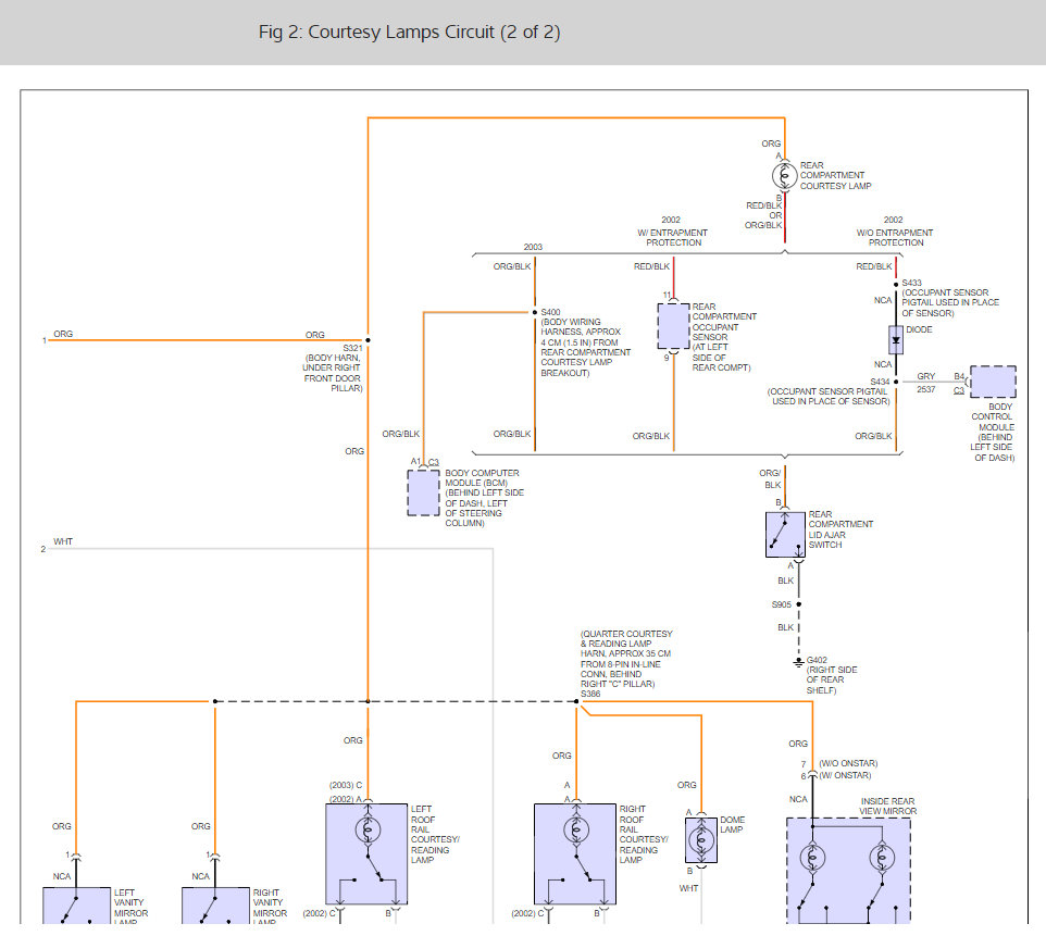

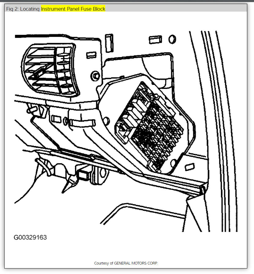

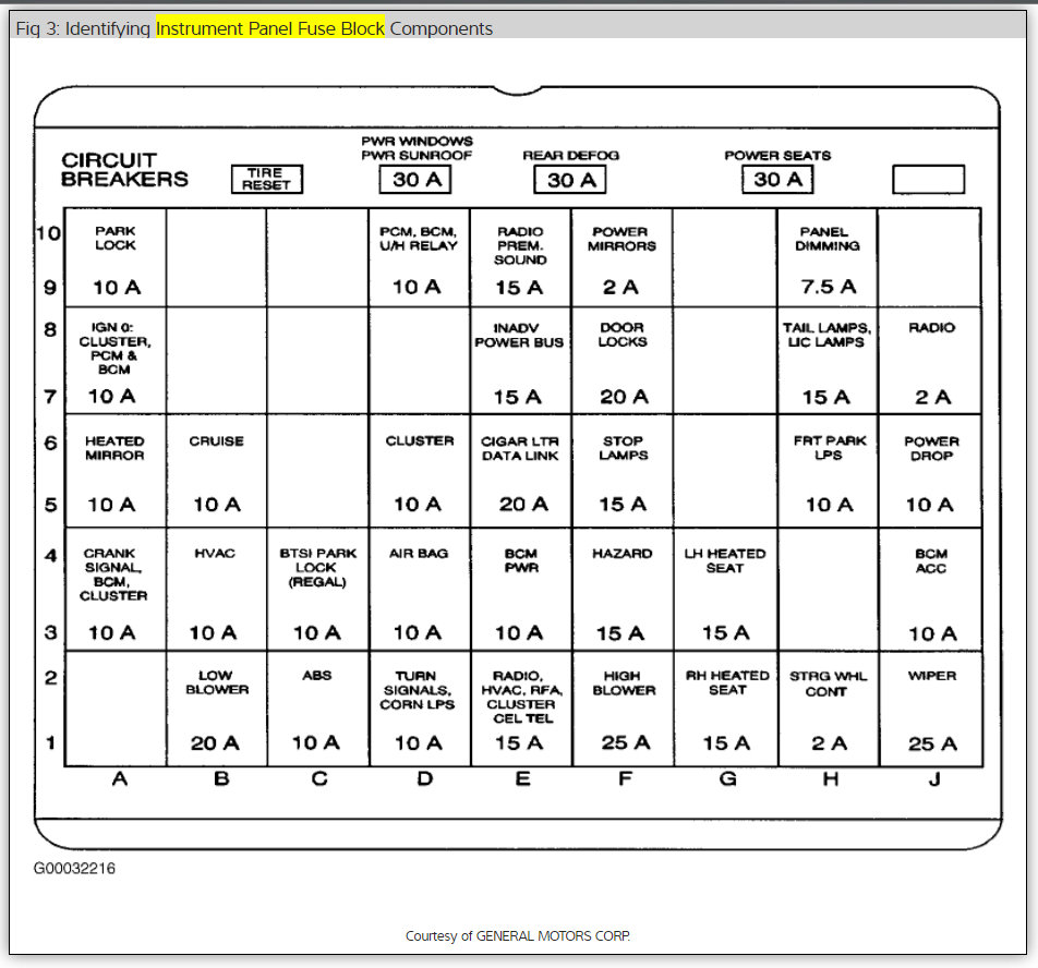

i have a 2002 buick century and my dome and review mirror lamps do not work. I have tries to locate a fuse to see if it was blown, i couldnt find one what could be the problem?
Jan 11, 2008 at 8:18 AM
  • 55,433 POSTS

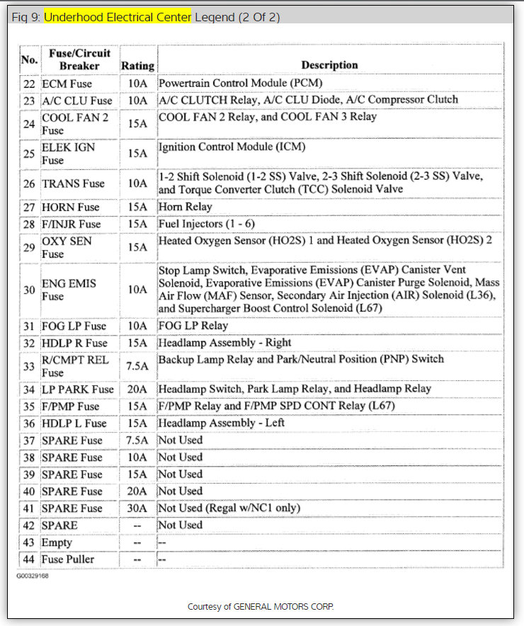

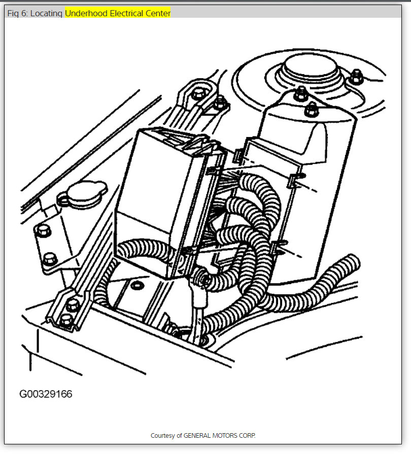

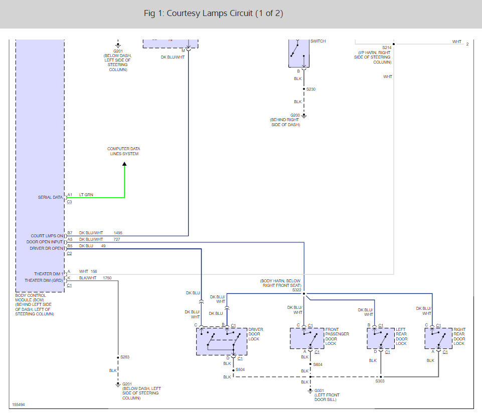

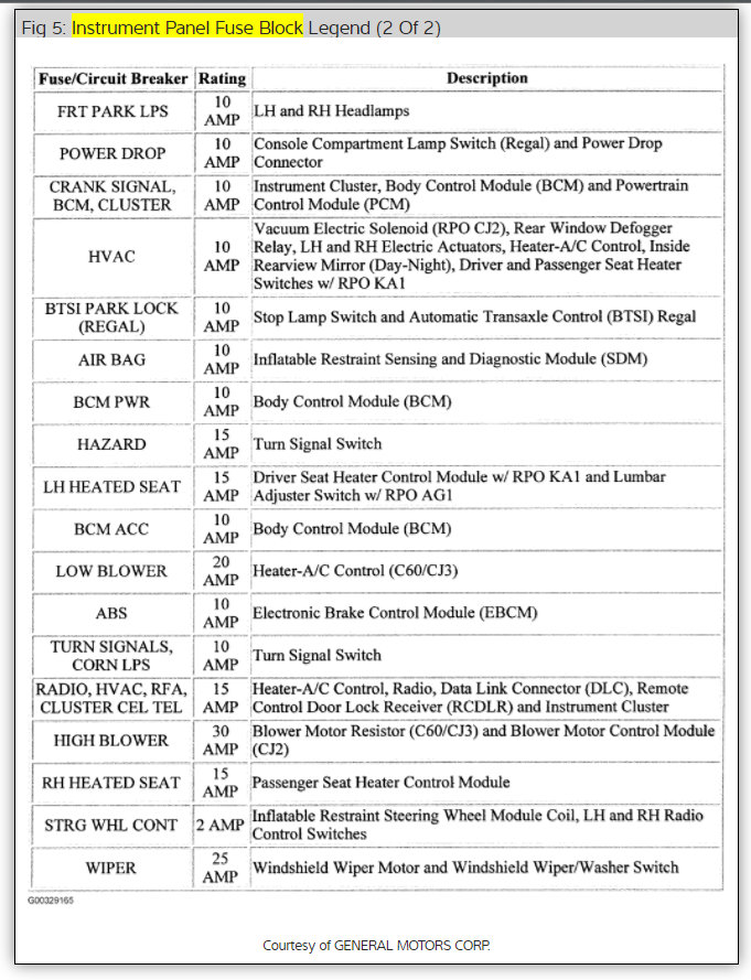

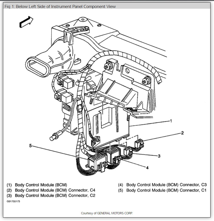

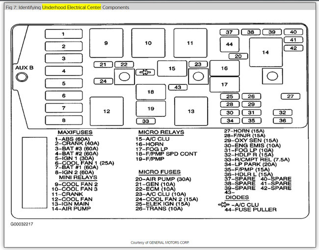

These lights are controlled by the BCM so there are more than one fuse that needs to be checked, Here is a guide and some diagrams (below) that we help us get the problem fixed.
If everything checks out I would check to see if the lights work with the other doors, if not then there is a wiring issue or the BCM is bad and needs to be replaced. If you get a used one it could plug and play if not a shop will need to reprogram it.
Please let us know what happens so it will help others.
