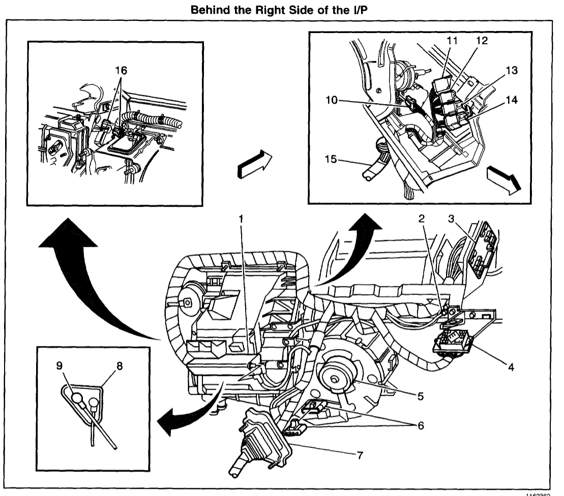

MAHGNINNUC93
Heater problem 4 cyl Front Wheel Drive Automatic 9800 miles
When I turn on the heater, my blower does nothing but push out cold air. Does this sound like a heater core problem to you?
Jan 23, 2019 at 6:25 PM (Merged)
  • 54,837 POSTS
If your coolant level is full then I would say it sounds more like a temperature blend door actuator. Here is a guide to help you see what you are in for when doing the job.
Here is the location in your car.
MAHGNINNUC93
Nice work I checked the coolant level it okay so I did the blend door actuator like you said and now everything g woks good! thanks for you help :)
